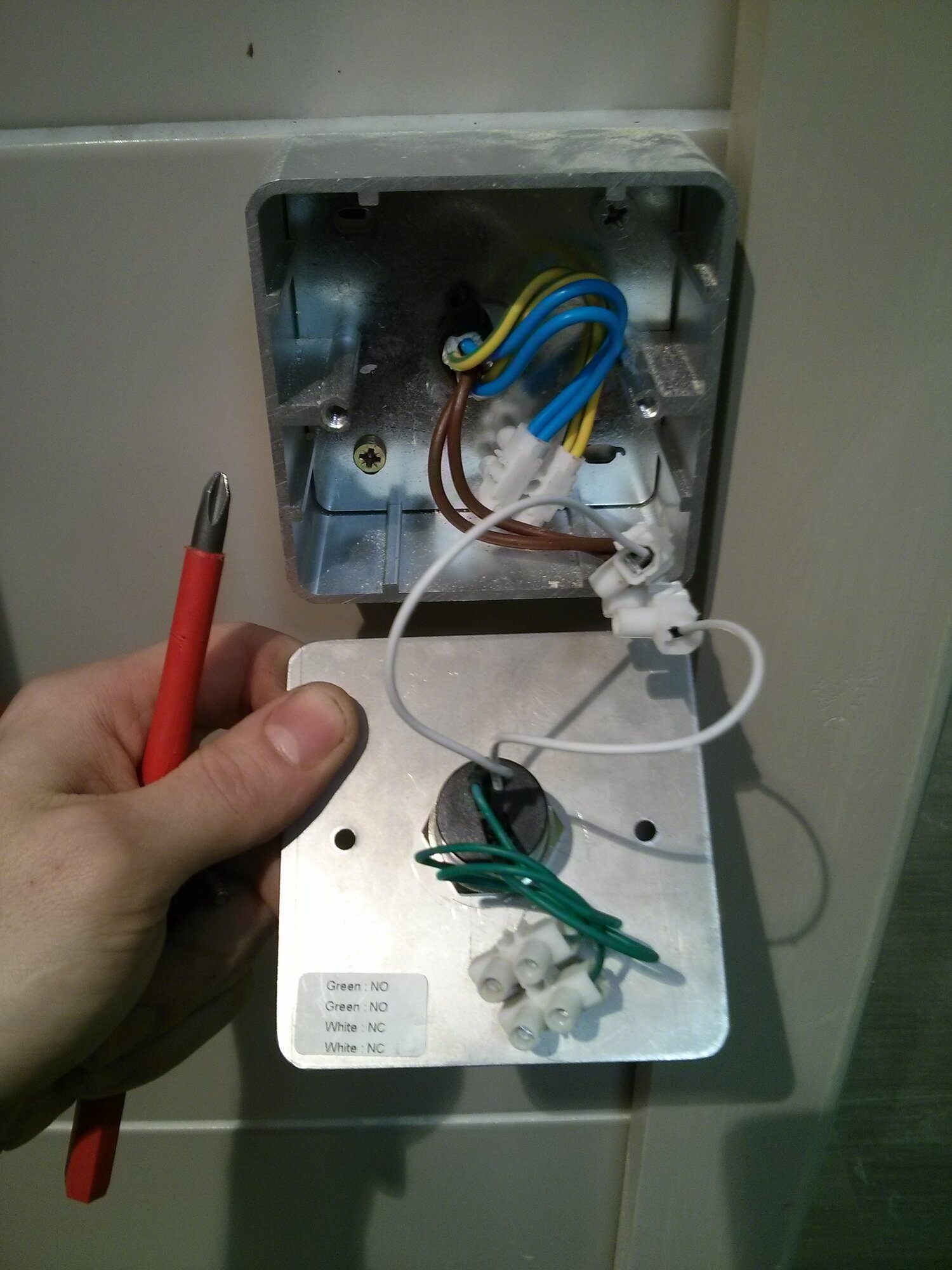

Here's the transformer with my feed coming in and a flex leading out to my first switch
Feed in
First switch in the till station white labled as n.cIMG_20220107_091054.jpgnext switch inside the bathroomIMG_20220107_090751.jpg

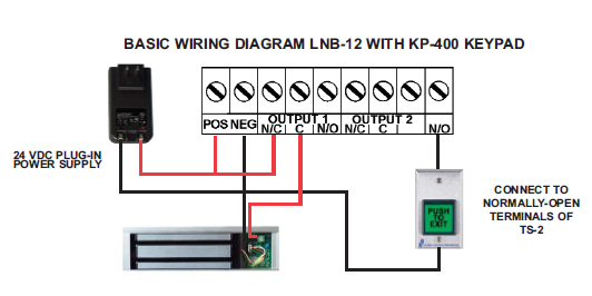

Do you have the connection diagram for the transformer as it looks like your wiring is wrong
It looks like the door release buttons should be connected to terminal 6 and possibly terminal 5 as normally open buttons
With the magnet directly connected across terminals 1 & 2 when you press the release button you will get a timed lock release
Not read this post properly, but looking at the circuit diagram above, you have two NC pushbuttons connected in parallel. They will only do anything if both are pushed at the same time.
Hi, I have come across one of those power supplies in the past, it has a built in timer to release the lock.
The lock is wired into terminal 1 +ve and Terminal 2 -ve
The release buttons are normally open so you use the green pair on each one, wired in parallel. These are wired into terminals 5&6 it doesn't matter which way round.
The lock release timer is adjusted by the pot to suit the site as required.
