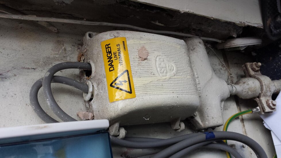

hi can someone tell me what fuse this is please. is it a bs88? thanks

Here we go I shall spell it out for you. How can we tell when we can not even see the fuse?
What you have there fella is a picture of the fuse enclosure. The actual fuse & carrier will be inside it.
wouldn't be surprised if its an old 3036 rewrieable!
OK, thanks Spinks.
Sorry for the way ive posted, my mistake here putting that as the post description.. ive just bought the property and what I am looking at is there is 2 wired fuses inside line and neutral . its not a bs 1361 what i have seen before. do you know what i mean?

ok thanks. whats the deal with these then is it dangerous with a neutral
Yes a fused neutral is very dangerous and should be changed ASAP.

You shouldn't go anywhere near that enclosure, it belongs to the DNO and it's an offense to tamper with it. It's also cast iron and can't be isolated (made dead) so there's a risk of contact if you move the lid. Finally there may be asbestos pads which shouldn't be disturbed. If the fuse blows you should get the DNO to replace it.
