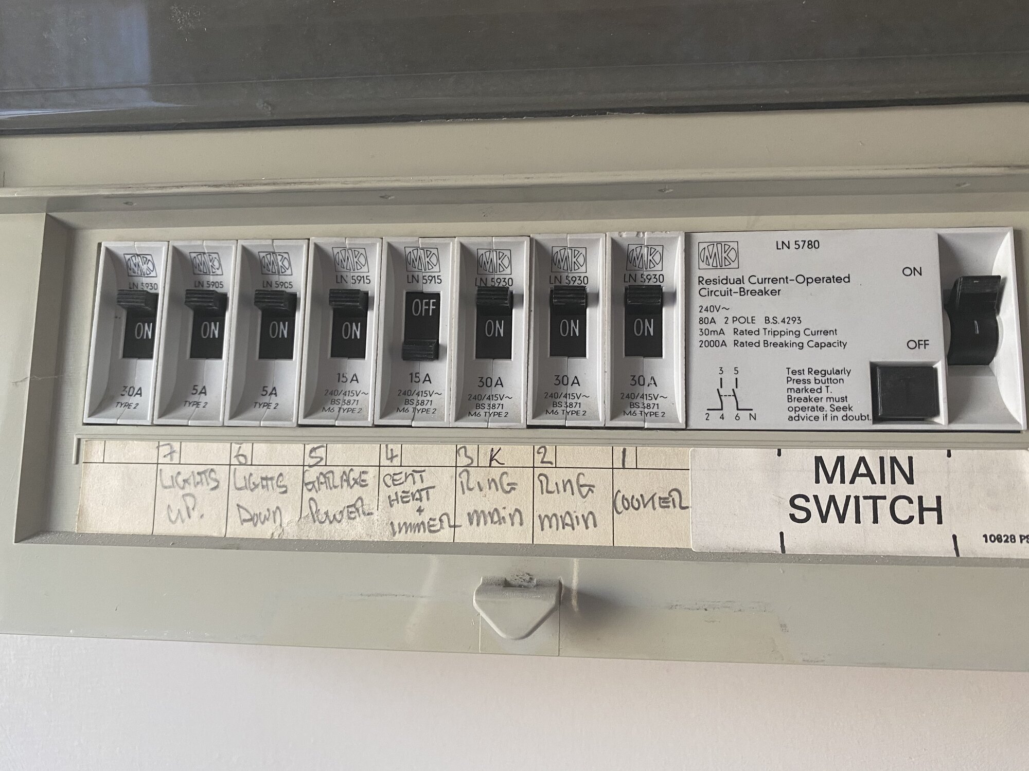

Rcd has main ring left, making ring right, garage, cooker, kitchen all on the same board. But youre right, one board with probably 5 circuits.
As said all appliances work on the kitchen ring, but the minute the mains left and right is flipped up, it trips the whole board.
So my understanding is that the cooker switch is the hob which is working, but the central heating is an old heating system we changed to a combo boiler which is now the oven main switch.
This switch remains in the on position of all others are on except the main rings.

If you are having substantial work done (sounds like you are) then I'd include changing that board for something more modern that better meets current regulations. There is one RCD that a fault on any circuit can trip, and often you've no idea which circuit has the issue. Get an all-RCBO board fitted, where each circuit has it's own RCB built into the circuit breaker - so a fault will trip only the one circuit.
I was going to advise exactly the same thing. That board has done well and it's now fairly old. I believe it's an original MK Sentry board, and any parts would now only be available 2nd hand.

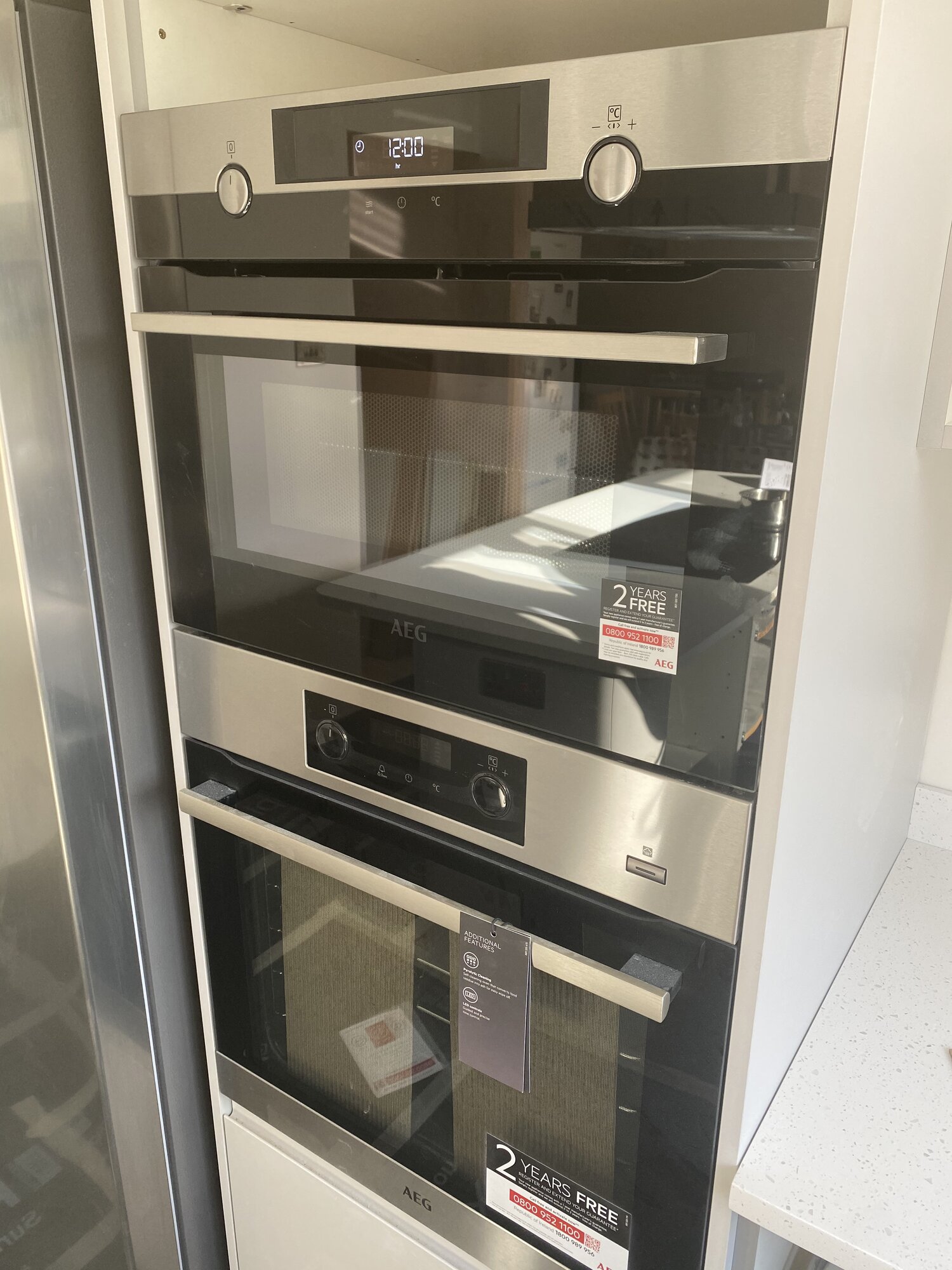

You said the "Cooker" is the Hob and "Immersion/Heating" is the Oven. At first glance that Oven you photographed is likely to require more than a 15A breaker. It might actually be the other way around.

Yes there was talk about a new board at the beginning but because of the additional circuits on the board not being used, it was suggested to use those instead.
Just tested hob with the board as shown in picture and it turns on so will check again why the cooker is on the 15A breaker. Thanks
Just checked specs on manual installation and picture below:
