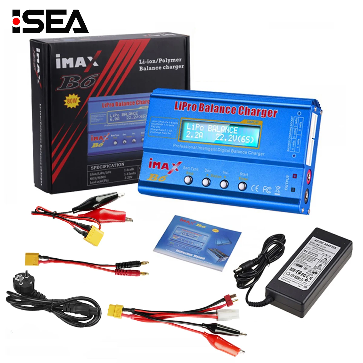

I thought about getting this charger:
Are you familiar with it?
Thanks :)

If you solder your packs up, you will need to also solder on your own balance leads, these will depend on what charger you buy which obviously must have a matching balance connection and be of sufficient capacity to charge whatever size pack you make up.
