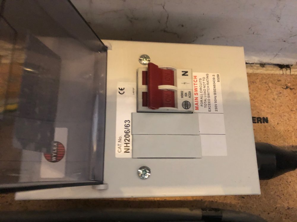

I have been asked to do some work on a large 25 room mini mansion spread over 3 old properties made in to 1 with 6 consumer units on a single phase 100amp supply. The total loading of the breakers is 452 amps if I apply diversity at 40% I arrive at 180.8amps demand but this dose not take in to account fixed loads like 2 x water heaters & under floor heating etc, when calculating as per OSG the demand comes to 355amps.
When I mentioned the large potential demand the customer got very upset that a additional 100amp phase may be a wise idea and said the classic its "been"like this for years with no problems" my question is am I being over cautious?

I got asked to fix tripping RCD (underfloor heating in conservatory) then we started to basically do a EICR and discovered the installation is a mess, I have found a supply to a garage on a sub main with only a main switch no protection for its entire length of 60 meters in SWA, starts in 10mm then its split into 1 x 6mm to garage cu then 6mm again around the house to a conservatory cu (installed 5 years ago) approx 45 meters, no selectivity between consumer units, no RCD protection on circuits though bathrooms etc. original rewire approx 25 years ago by a BT engineer, no oil bonding on brand new boiler, the 50+ garden lights connected in chocbox connector boxes wrapped in tape the list just keep going.
