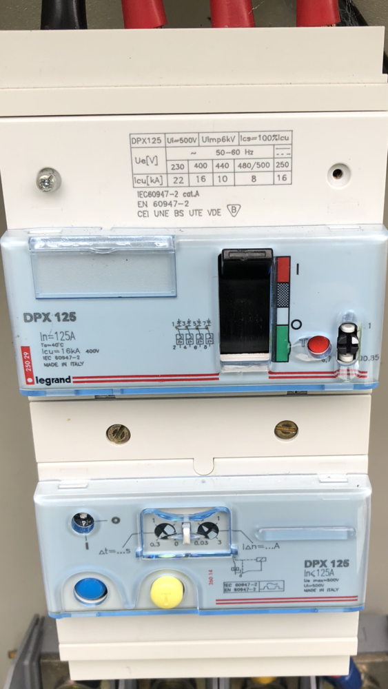

Would anyone know the max tripping time for this earth leakage device?
I’m guessing 500ms it’s time delayed but I know that figure is for RCDs and RCBOs, I tested it at 560ms
Up to 3 seconds - turn the dial to 0, 0.3, 1.0 or 3.0 seconds - it is set at 0.3 secs in your photo.
it's also set to 0.3A (range 0.03, .3, 1 & 3A) so what was your test current?
Yes set to 300ms time delay, it tripped at 560ms
[automerge]1584603181[/automerge]
Set to 300mA on tester and then set to (S) which is time delay
[automerge]1584603200[/automerge]
Is it not set to 0.3S ?
Yes it is
