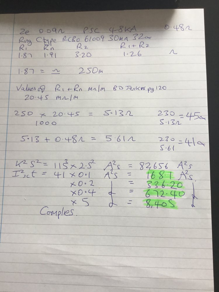

Why do we have maxuim Zs for 61009 RCBO's? I didn't think Zs values really mattered if the circuit was covered by and 30mA RCBO/RCD?

But we all know that if a maximum touch voltage of 50v / 30mA = 1666 ohm an RCD of 30mA will operate (in theory) with a Ze of 1666 ohm?
The Rcd would provide earth fault protection,& so the 1667 would comply.
The main concern will the short circuit fault conditions be met,these will have to be worked out,with the thermal constraints & the Adiabatic equation,to make sure it then complies.
I see... So you use the measured zs value ( or r1 r2 ) to work out the length of the circuit ( of the line an neutral conductor) and then use the Adiabatic equation to calculate if the short circuit fault condition will comply?

Because theses are the values that you should work to,especially on tn systems.
Its second nature these days to forget about these values & stick a Rcd on the high values.But Realistically ,these are the Zs values to be used.
If you use a Rcd then a short circuit calculation shoul also be done to make sure all is ok.
