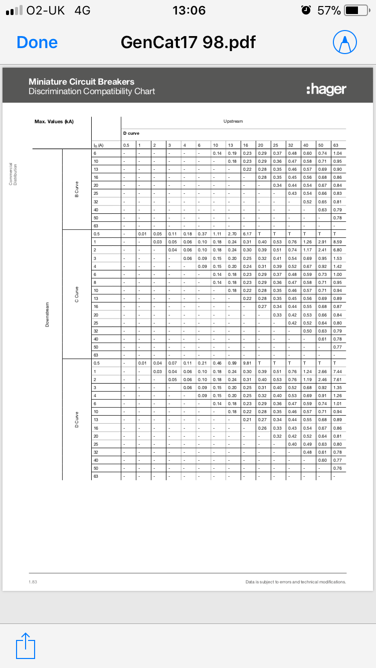

I have a Schneider chart that shows discrimination is achieved between 6A and 63A type B circuit breakers up to a short circuit current of 250A.
@Ian1981
Why have you posted a chart of energy let through against ampage?
The charts we need are time/current curves for all 3 types of mcb.
Given the 63amp is probably a submain supply we can use 5-seconds fixed load, as we are discussing a 6amp mcb then it is unlikely we need to factor 0.4 in as it makes little difference to the outcome.
63B-6B has FD up to approx 250amps
63C-6B has FD up to approx 610amps
63D-6B has FD up to approx 1300amps
The only thing to be concerned with when using a C or D is that zs is still met, but the majority of installs out there are domestic so we can use the charts directly been single phase in most cases (no need to calculate 400v fault current)
