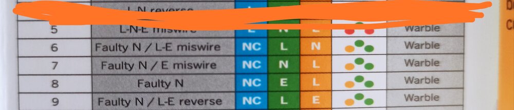

While waiting for Electricians to get back to me, I got a kewtech 107 as an interim peace of mind.
All sockets check out fine except one....
Alarmingly I get a warning condition on the neutral wire when the socket is not turned on.
If the kewtech is plugged in when the socket is on, the tests all pass and there are no errors.
Is it safer to leave the socket:
With the switch on and nothing plugged in
With the switch off and nothing plugged in
With the switch on and something plugged in arbitrarily on standby.
These are the fault conditions that correlate with the tester being plugged in and the socket switch off....

Worth noting that the socket with the fault is a double socket and only one side exhibits the neutral fault when switched off

Anything that causes an MCB to trip without load is a short-circuit, which a socket-tester does not detect. It will tell you (sometimes) whether the wires have been put in the right holes, but not whether they are arcing and sparking and about to catch fire. It could be a damaged cable or fitting, or even an appliance, as it is possible to trip a B32 MCB even while a 13A fuse remains intact, although I would expect the 13A fuse to have gone by now after a couple of trips.
As it only happens on one socket of a double, it is unlikely to be reversed polarity at the connections. If the socket has a double-pole switch, it could be that the line pole is welded shut but the neutral is still working. Therefore, when you switch it off, the tester detects it as a missing neutral. Replace this socket while fixing the short, avoid using in the meantime as anything connected might still be live while seeming to be off, or the switch may arc if it is partially jammed.

The socket in question was in the general direction of where my other half heard a 'pop' when the MCB/RCD last tripped. Equally the switch on this particular switch stuck in the 'on' position the other day and it took me about five attempts to click it to off. The appliance plugged into this switch was a coffee machine which were most suspicious of as a cause as it sometime behaves erratically (auto timer not cutting off/random numbers on the display).

Now this is starting to make sense, ironically with the aid of the socket tester.
A likely cause is an intermittent but direct L-E fault to earth in the coffee machine that had been making occasional light contact, but when the pop occurred, the fault current was high enough to damage the switch on the socket while the MCB tripped. The fuse in the plug might have survived earlier momentary fault contacts partly due to the RCD also tripping and reducing the let-through, but has probably opened this time. When you freed the switch off mechanically, only the neutral pole actually started to open and close; the line pole is still welded closed hence the socket tester indication.
If you still have the coffee machine, you might like to open it up; the fault will probably have left visible evidence as unless the functional switching is in the neutral, it must lie between the flex inlet and the controls and is unlikely to be hidden within the element. It would also be interesting to see whether the plug fuse has indeed opened, and whether it is genuine or counterfeit/substandard.

Thanks so much for the reply!
Had to pretty much destroy the coffee machine to get it apart (cheap moulded thing). The main PCB has a some significant scorching around a bunch of components, equally the chamber that houses the inlet from the flex/element and the main PCB has clearly had some degree of water and coffee ingress over it's lifespan.
