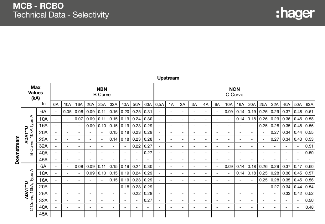

So when you say it will not discriminate on a fault what do you mean? The MCBs in the garage board have never tripped it’s always the 40A MCB one. So if there was an overload somehow being caused it would trip the 16A one first no?
Fault discrimination, now known as selectivity, is the ability of a cascade of protective devices to only trip the closest to the fault.
In the case of MCB they are selective on overloads that take time on the thermal trip side (so up to x3 or so from the rated value of the upstream device) but if you get a big fault, such as a short-circuit, then both devices would have the "instant" magnetic trip underway before the downstream device has actually opened and isolated the fault. Basically in many case both devices trip.
When cascading breakers when it matters, you need to add a short delay on the upstream device to give the downstream one time to act, but if it does not (or the fault is before it) then the upstream will go. Usually that means using a MCCB (at high cost) or a fuse (cheap, effective, but a pain to replace and typically means electrically-skilled staff).
If you look at commercial/industrial catalogues of electrical devices they often will have tables in the back giving you the selectivity limits for various combinations of fuse/MCB, MCCB/MCB, MCB/MCB and so on.
They passed with the max reading off the tester. So when you say it will not discriminate on a fault what do you mean? The MCBs in the garage board have never tripped it’s always the 40A MCB one. So if there was an overload somehow being caused it would trip the 16A one first no?
Thanks for your reply though mate
By not discriminate I mean if there is a fault then there is no guarantee that the 16A MCB will operate before the 40A MCB.
If it is an overload then the 16A will operate first yes.
Example table from Hager. Not quite your case, but if you had a 40A B-curve MCB feeding a 16A B-curve RCBO then any prospective fault above 0.19kA = 190A is likely to trip both devices:
