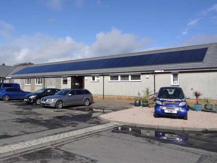

Avoid all these problems and use either Viridian Solar Fusion or Solar Century Sunroof. Viridian system is tested to BBA standards including resistance spread of fire etc. Quick to install and looks fantastic.
Here is one I did Earlier (last month).
