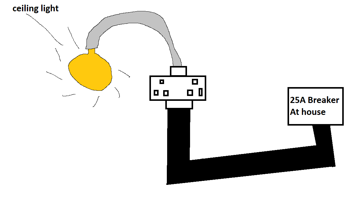

Okay so, I have a shed down the end of my garden where I like to weld and do stupid stuff. Anyway I have an arc welder which at maximum power gives me 160A @ 20V which is 3200W. When my parents built the shed they didn't take into account that there son was going to be a raging metal melting maniac and hence there is just 2 G-pin 13A @ 230V AC sockets in the entire shed, very inconsiderate I know. This of course allows for a maximum of 2990W which just isn't good enough if I want to weld thick steel without the fuse going every 2 seconds.
Luckily the electrician clearly saw my future struggles and popped in a 25A breaker for the shed on the mains board back up at the house when it was built. But here's where things get a little iffy: The cable for the shed comes in though a big dirty black wire from the house underground and goes straight into the G-pin sockets and then a smaller grey wire goes from the sockets to the strip light up above. (I've attached a highly detailed diagram below) I assumed that the strip light was just in parallel with the power coming into the sockets and turning off the power for the shed at the breaker would therefore turn off the sockets and the lights. But alas it only turned off the sockets and the lights are still fully functional. I don't know what witchcraftery this is but I don't really want to open up the socket and have a peak if there's live electricity going through her. My plan was to just attach a big 16Amp connector to the big dirty cable but it seems a bit tricky as I've no idea whats going on inside the socket.

I have to say Peter, that is without doubt, the dumbest idea I have ever heard of, you need to get yourself a quick dose of realism and employ an Electrician to install the proper wiring and switch gear to attempt the work you would like to do, either/or this has to be a wind up.

Hi Peter - can you tell us about the welder? Is it the 13A fuse in the plug that's melting?
It hasn't melted yet but i'm assuming it will if I crank up the welder and draw 16A from the circuit. It's also probably safer to have a proper heavy duty connection over a Gpin

What breaker size do you need for the welder?
How do you sw2itch the light on and off?

Well I have a 25A Breaker installed and there's a switch on the wall i'm using to turn the light on and off (between the light and socket on the gray cable)
Yes, you stated that there is a 25A breaker. You also stated that you thought of putting a 16A connector onto the cable.
So the welder will not need more than 16A then, but what is the max rating for the input. The output is in your original post.
From what you have put so far, the whole wiring of this sounds dodgy...
Max input for the welder is 38A

No one on here is going to advise you on attempting to fix the problem yourself. The advise given so far is the correct advise and my advise is that you take it. :- You need to hire the services of a good electrician who can then advise you on the best possible option for what you require.
The job maybe a simple fix and you might be able to achieve what you want relatively cheaply, alternatively what you want may not be safely do-able without re-doing the install entirely. But we cannot soundly advise you on this over an internet forum without the full details and an initial inspection of your current set up.
