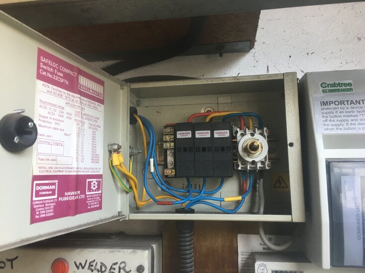

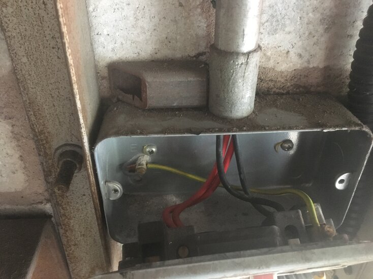

1, sockets arnt earthed (10 or so sockets fed from 20mm conduit and thats fed from 50x50 galv trunking they say it requires its own cpc (check pic out)
my question are they correct or does the conduit and trunking surphise / accactable and why didnt they pick this up when they changed the board ?

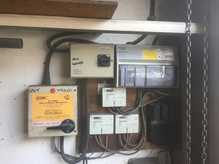

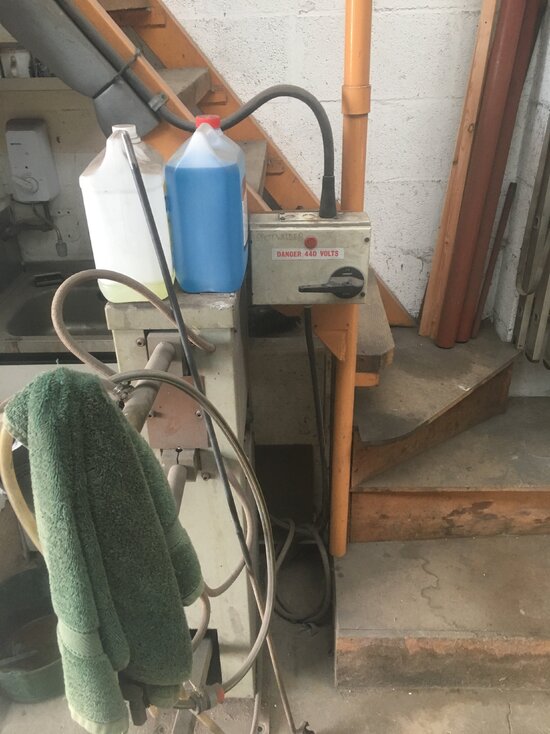

2, my 3 phase spot welder isnt earth and you cant use the swa as an earth as it doesnt have banjos on the metal boxes either end so need to be re run
my question i think this is bollox but at most it just needs banjos fitting

It is perfectly acceptable for the armour of a swa cable and metal containment such as steel conduit and trunking to be used as an earth providing its continuity is satisfactory. The swa cable should be fitted with "banjos" though.

tell me about it they didnt know how to wire up / from a 3 phase supply and said my 3ph welder was dangerous due to it only having 1.5mm hr flex needs 2.5mm only pulling 10 amps :D
as i thought and thats fine as i thought, so the gland and nut isnt really acceptable for earthing (yes the armor is terminated correctly)

banjos may not be necessary if the metal casings provide earth continuity and there are flyleads added where neeeded.

right had an hour to spare
tested from the earth point in the isolator (spot welder end) to armoured sheath and got continuity
other end tested from earth point on the fused supply to the armoured sheath and got continuity
now tested from earth point in the fused supply to the met and got continuity
my question
from the met to the earth point in the isolator (spot welder side) via a fly lead what resistance roughly if any am i looking at
all depends on the csa of the cable or the armour and it's length. figures can be obtained in the osg.
