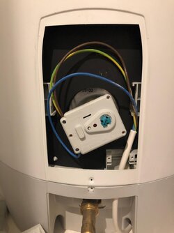

Can anyone tell me whether these wires are suitable for a non experienced individual to be near or exposed too if they have no knowledge. We were told by our landlord to access the thermostat shown but the wires surrounding it are live and need insulating (nothing about insulating wires was mentioned). I myself, would not know to isolate live wires... I am just wondering if this is deemed safe? Thanks!

There should be a cover, with perhaps a dial on the front that slots onto the blue dial showing.
If the cover is missing, then the LL should replace as soon as possible. It looks like a water heater(?) so you are being asked to adjust the temperature with possibly wet hands?
Cord grip for the flex appears to be missing too.

All of the wires shown are insulated and thus there is no risk of electric shock from them.
There are no exposed live parts that I can see.
There should be a cable clamp (like those you see inside a plug) to secure the cable and this is not in place - it may be inside on the floor.
The plastic cover should be in place at all times.
It sounds like the landlord has asked you to adjust the temperature of the water to suit your needs. There is no electrical skill required in this, you just switch off the electricity supply at the switch and rotate the blue knob (using a screwdriver which will fit into the notch in the centre) to adjust the temperature up or down. Generally to lower the temperature rotate the knob anti-clockwise and to increase rotate clockwise (to the right).
There are two arrows, one on the knob and one on the outer body. When these arrows are aligned opposite one another, the water temperature will be at a level that the manufacturer considers is ideal for everyday use, and you may want to align them first and see if the temperature is suitable.
Once done you can replace the cover. If you find one, you ideally should place the cable clamp to secure the wire, however as it stands there is no mechanical weight on the cable that would represent a risk to the connections.
Now you can switch back on.
If you still feel uncomfortable then the only solution is to ask your landlord to do it, or get someone who is more confident.

The pictures you have supplied show the water heater thermostat which is completely different. This sets the temperature which looks if it is at maximum.
So, you need to find the control unit for the heating and see what it shows. It could be that it is set to run constantly.

So the cover isn't missing, And the instructions are there.
Everyone else is right. Isolate power - remove cover - adjust temperature - replace cover - turn on - test temperature.
