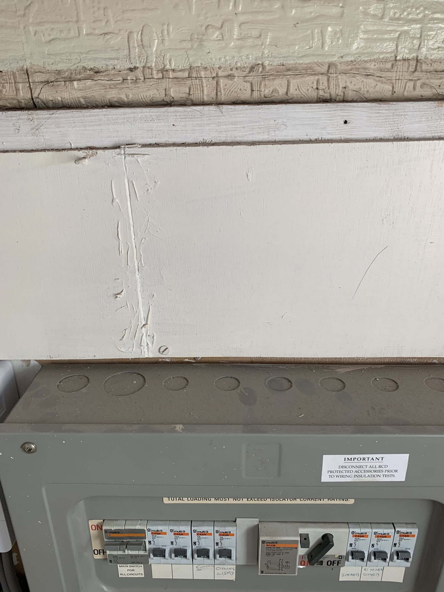

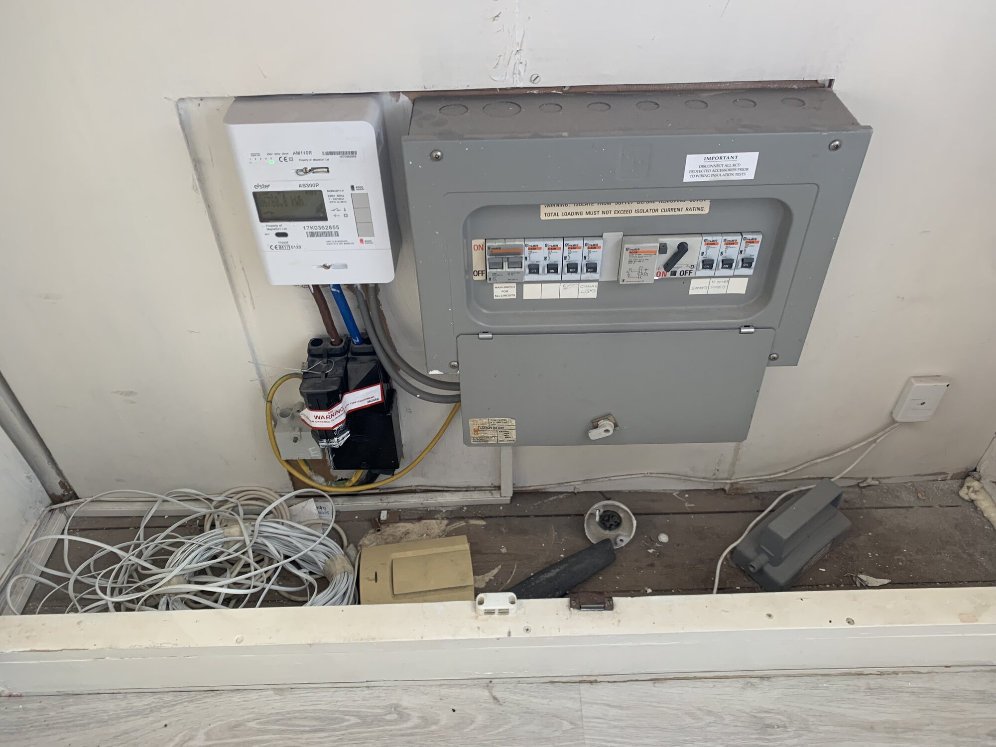

That is your distribution board “fuse box” can you post a picture zoomed right out that shows everything electrical in the room?

I'd say that the Fused Cut out, black box with warning label on, for the other flat ( is it above you?) is not in the flat and the meter installer is assuming it's in yours.
As it doesn't appear to be, it's probably in a cupboard or box elsewhere in the building and has always been accessable or is in another flat.
What's on the other side of the wall behind your meter and fusebox?
The answer to the other flats problem is where the black cable circled blue goes to, as theirs will be in that location,

No bud her flats below mine. Ive honestly no idea whats on the other side. Nothing i don’t think. Looks like boards nailed into the building (im by no means knowledgeable though)

Unless I am missing something that service head appears to serve the OPs dwelling, one cable and one fuse from what I can see.
Yes that's what I think, but wherever that service cable enters the building then the other 3 probably do as well.
It may well be a single service the the building then split to 4
Any chance you can get the other flat occupant to send you a photo to post on here showing their meter and fusebox, the same as your photo in post #6?
Roughly where in Scotland are you?
There’s a few of us here that, if nearby, could pop in and tell you exactly where things are going.
I’ve seen flats where the downstairs has two cutout fuses… one for them, and one for upstairs… but you only seem to have equipment for your own house.
