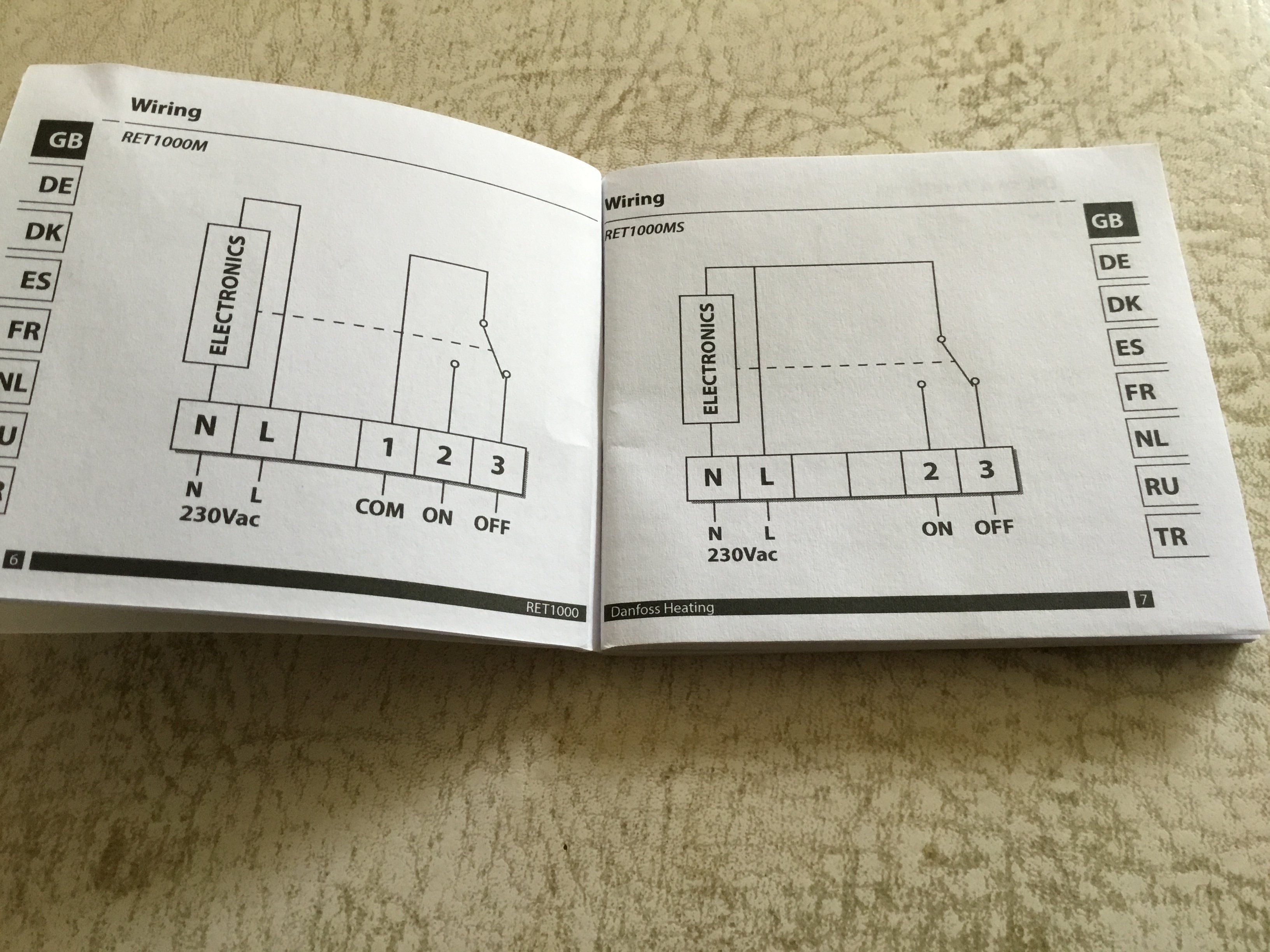

Hi just bought a nest e thermostat . Ive included a picture of the wiring for the old thermostat and the connections for the new nest thermostat. I just want to make sure it’s compatible before I get someone to install it. Which wire goes to which connector for want of a better question ?
you need a 3core/E cable instead of the T/E.
The nest thermostat is a combination of time clock and thermostat.
The base “receiver” unit can be fitted next to the boiler where there will be all the cables that you require.
The control or thermostat unit would normally be placed wherever the old thermostat is mounted and only needs 2 cores. This is to supply power from the base unit to the stat unit, as per the instructions.
All the control signals are sent wirelessly from the stat to the base unit.

Hi again, can I just clarify that this is a nest thermostat E that uses the heat link at the thermostat with nothing fitted to the combi boiler itself (obviously the thermostat connects to the boiler at that point). I’ve just spoken to nest tech support and told her that I only have a 2 wire system and she seemed very confident that they will connect to the C and NO and that the system will work.

so, if i read your right. ( bear in mind i have no knowlege of nest), he needs a 3core/E (or 4 core flex) from boiler to receiver, and just a pair to the actual stat., which mus be RF to the base unit?
with your existing stat, brown is L, blue is switched L. Gn/Y is earth.there is no neutral.
Yeah I’m going to get a professional to do it for me, he’s doing it as a favour so I really wanted it to be as simple as possible and that’s why I bought the E . It’s also a housing association property so if it’s going to require a neutral wire installed then I’m probably going to require permission and other red tape before I can go ahead which will probably lead me to just not doing it.
I’m curious to know why telectrix knows it’s a switched live and not a neutral as every website I’ve looked at says neutral is a blue wire. Is it to do with the wiring diagram I uploaded?
