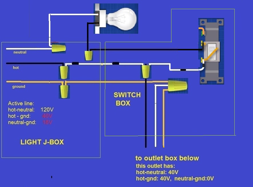

I have an outlet in my home that is wired in a non standard manner. Its neutral and ground are connected together based on the wiring diagram below. Please note I have identified the root cause of the 40V and 17V and fixed it. So I got 120V between hot and ground, 0V between neutral and ground in the light J-box.
The diagram shows that there is no true neutral wire from the live cable going to the switch box and the outlet below the switch box. To get the outlet to work, the neutral of the outlet is connected to ground inside the switch box.
Is this outlet wiring legitimate ? Does it violate NEC code ?
If it is OK, I can make use a GFCI receptacle here for ground fault protection and hope that it is code compliant.
I appreciate all advises on this matter.
you need to get a neutral to the outlet and separate the ground. end of.
Well, the light J-box is pretty far from the switch, all cables are inside the walls. There is no practical way for me as a DIY to add neutral to his whole thing. The wiring is original in this 40 yrs old home.
Look like this outlet cannot be made working without violating NEC code.
I will remove the receptacle, cut off both ends of the ROMEX cable and put in the blank cover.
This way, it is out of sight and... out of mind.
There are two outlets nearby, on both sides but not the same wall !!!

Neutrals and grounds are allowed to be terminated on the same neutral bar in the first panel after the power company's transformer but in the field it is a violation of the NEC. Loose and broken neutrals are hard to find and I will put them together to see if it starts working to help me troubleshoot, then I take it loose
This outlet has no neutral wire going into it. In principle it should not even be there.
I recently why connecting neutral to ground in and outlet is a very bad thing to do.
So I remove the receptacle, cap out the wires with wire nut (even they have been disconnected from the source), and put a blank cover there. Out of sight, out of mind.
