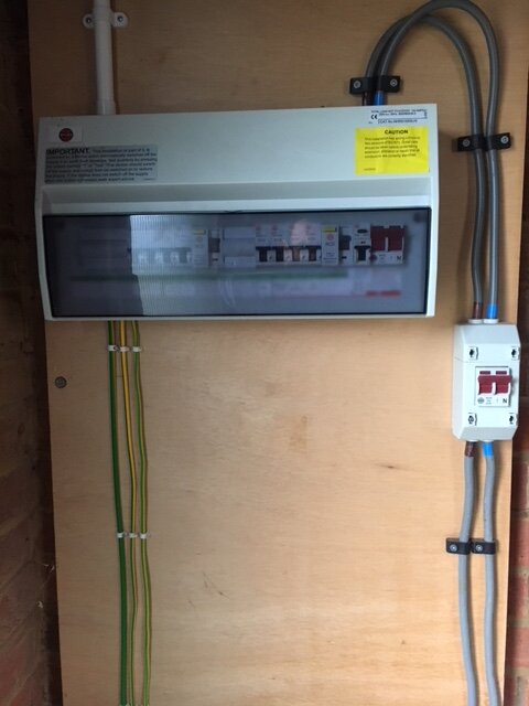

I am looking to sell my late fathers house and a bit concerned by the lack of certificates for recent (ish) electrical work. A new consumer unit was installed about 3-5 years ago and there is no paperwork with it.
I suspect that the work wasn't registered anywhere, so i reckon not done properly.
I want to get an electrician in to look at it, but should i be asking her/him to replace the consumer unit and carry out an electrical safety test? What kind of tests should I be asking for?
The house does have a mixture of red/black and brown/blue wiring so a bit worried that i might have to get the whole thing re-wired.IMG_4093.JPG

If the electrics are fine then there is no need for a new CU or to have it re-wired.
what he said ^^^^^^. get a report done, depending on the extent of the inspection test, expect to pay between £150 and £250. this will highlight any problems. then any remedial work can be done.
You could check your local building control web site, see if a compliance certificate was issued. If the installer had done that, I suspect the work would of been done with the appropriate certification.

Thanks all for the advice - much appreciated! I'll get an electrician in to carry out a an EICR and go from there.

But looking at your image that looks a pretty tidy job, would be surprised if a dodgy electrician put that much time and effort in and then didnt do the paperwork.
Got to agree with Gavin there it does look a good job.

Don't see that it will make much difference but when the DNO install an REC2S isolator, the supply comes in the top which they can then seal so the customer only has access to the outgoing (isolatable) terminals. In other words it looks upside down to me!
Also is that tape being used for conductor identification or has the sheath been removed?
Looks to me as tape.
