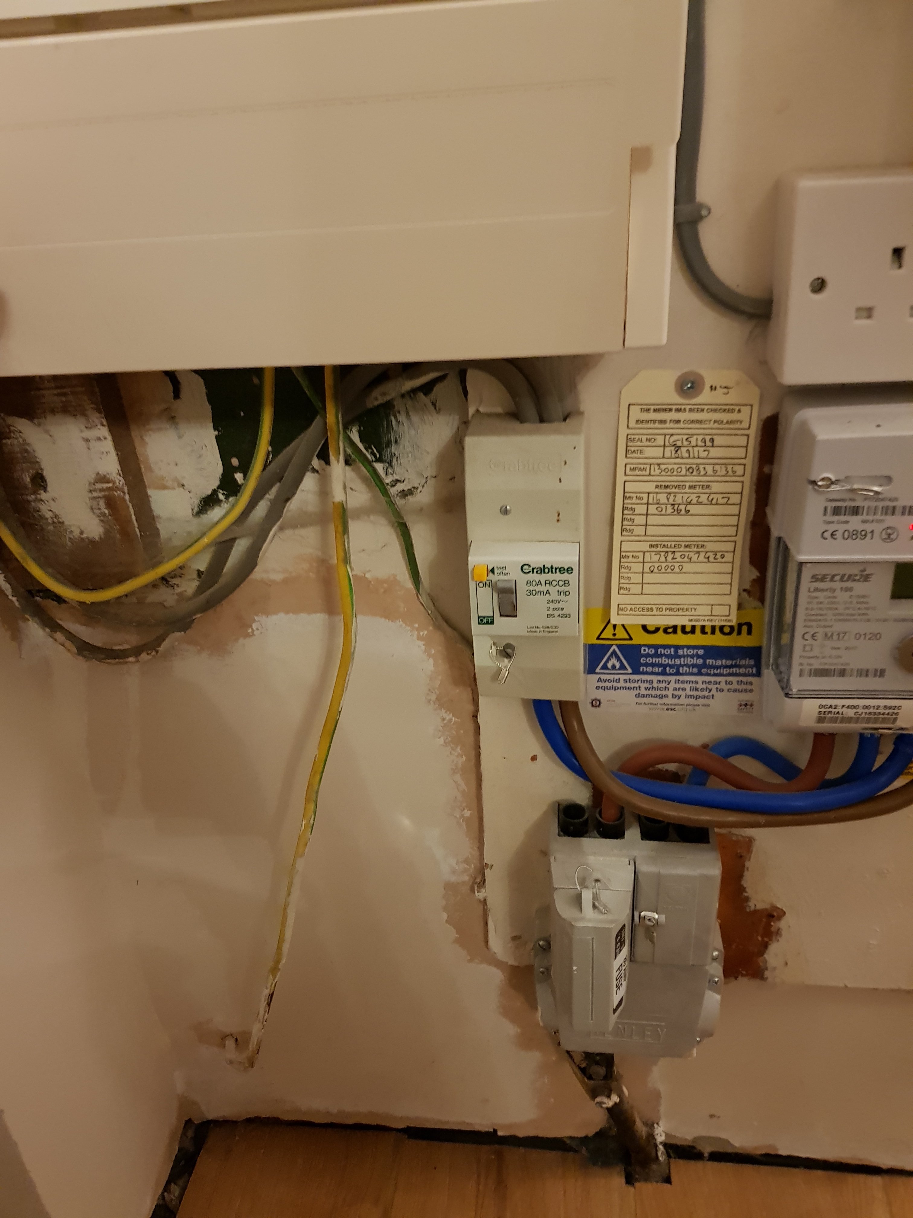

Earth fault. The 80A rccb is slightly more sensitive than the 63 in the CU even tho both are 30mA

RCD roulette. 30mA up front alongside a 30mA in the CU.

To clarify, that Crabtree RCD may no longer be required, only a site visit will say for sure. It may be possible to remove or change to a 100mA, again a site visit will be required.
The RCD on the cooker side of your consumer unit should be tripping first but as the two are of the same sensitivity it's a guessing game as to which will trip.
This does not resolve the fault but will stop the whole house going down when a fault occurs.

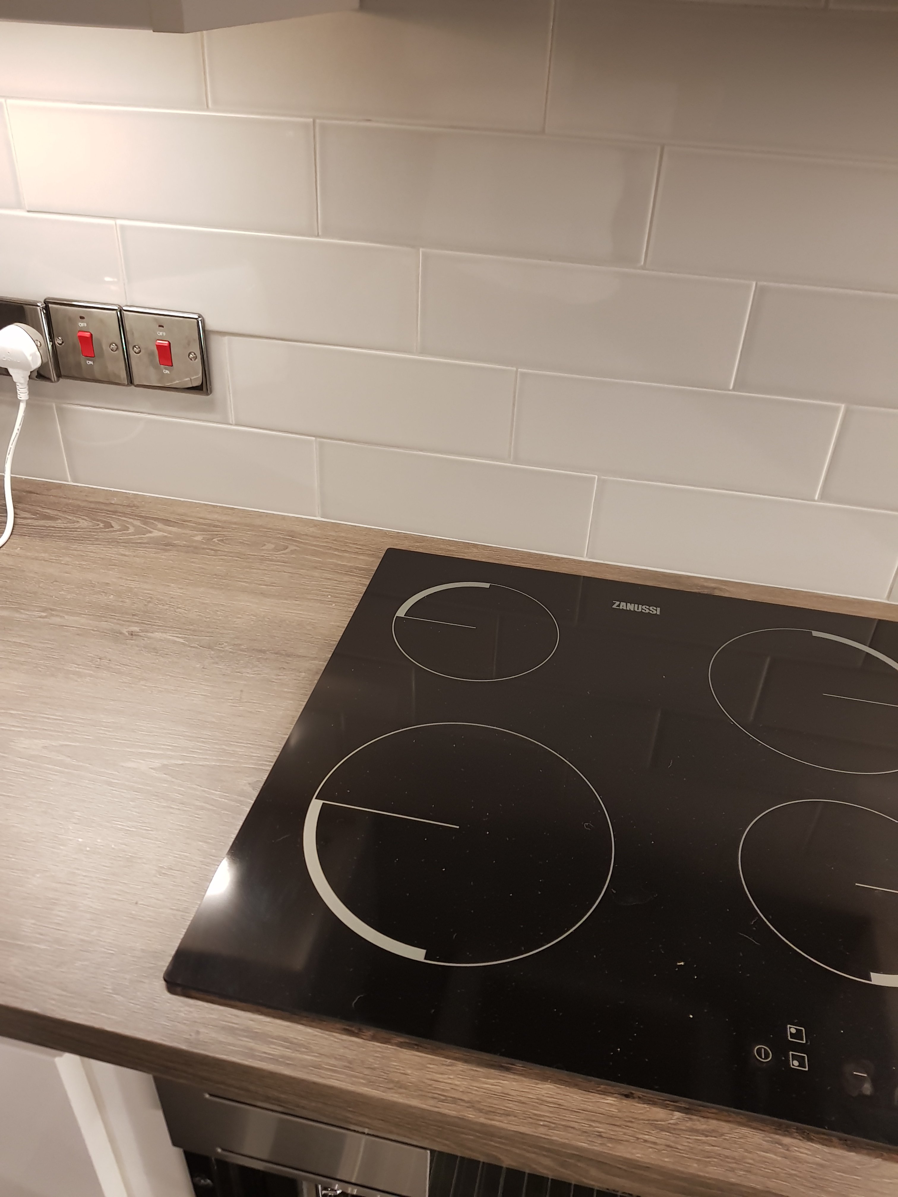

The two switches are probably a bit wider than a standard accessory plate, and the back box is a twin-1-gang, rather than two separate 1-gangs spaced apart. Hence something has to sit on top of something else!
