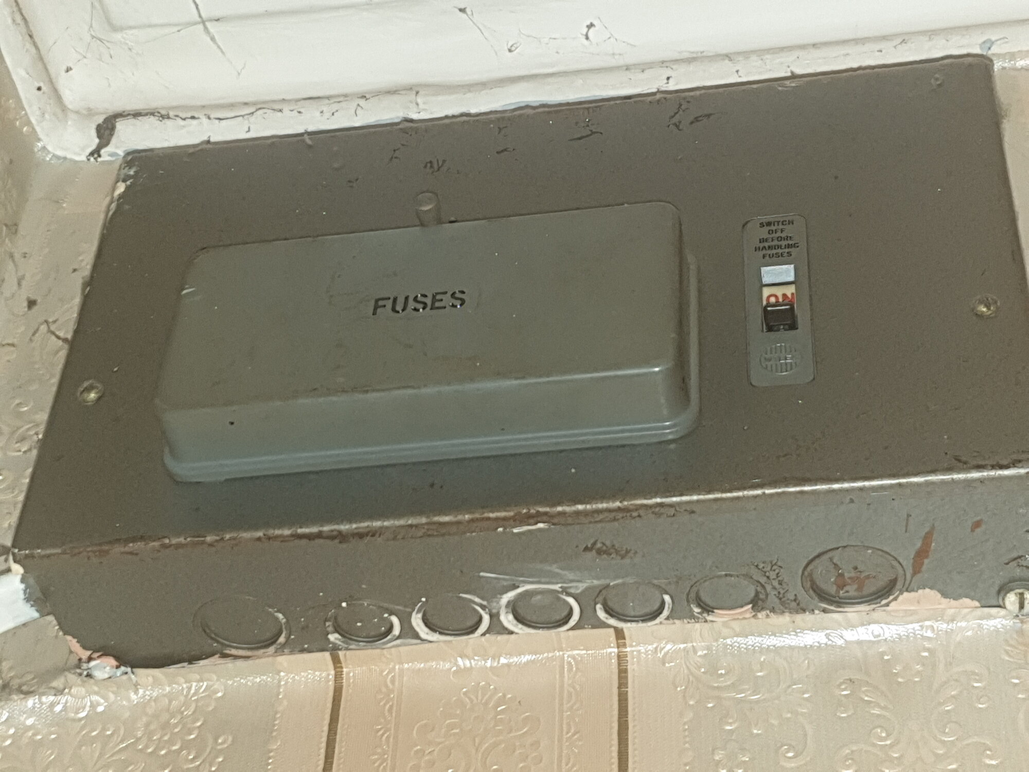

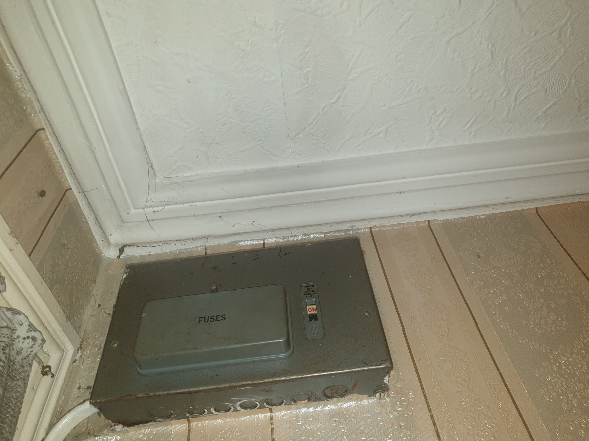

As asked above, can we get a photo of the the fuse board. We can then guesstimate the age of the installation. (The fuse board and wiring will be of the same age)

I've attached the fusebox we have now. It's over 25 years old
I cant open anything up to see inside as it's very high up and the stools I have to look further cannot access until tomorrow
Hope that helps
