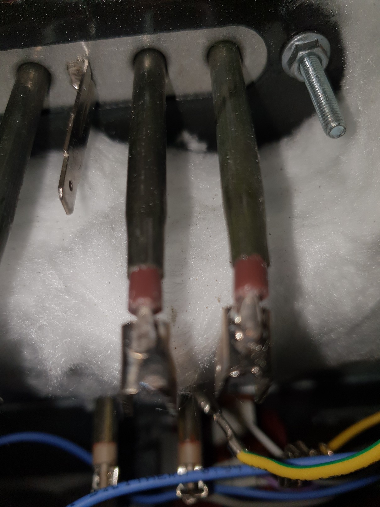

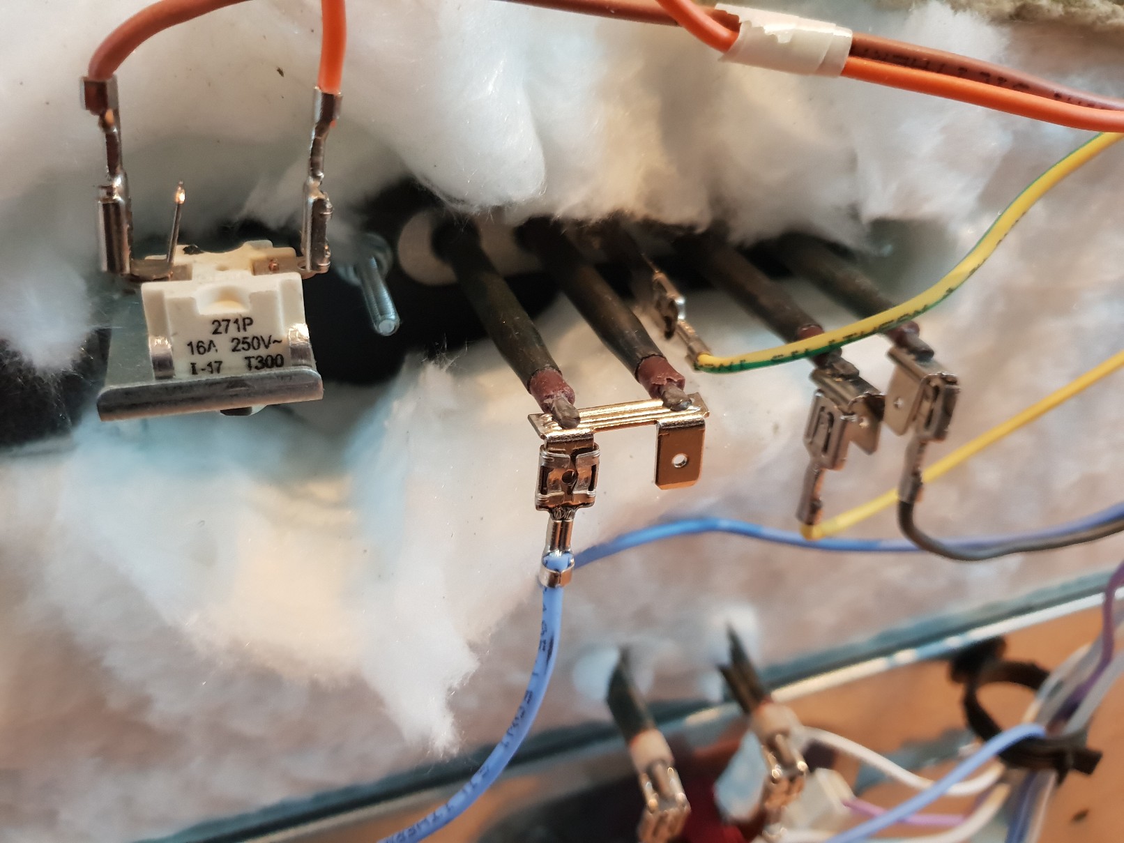

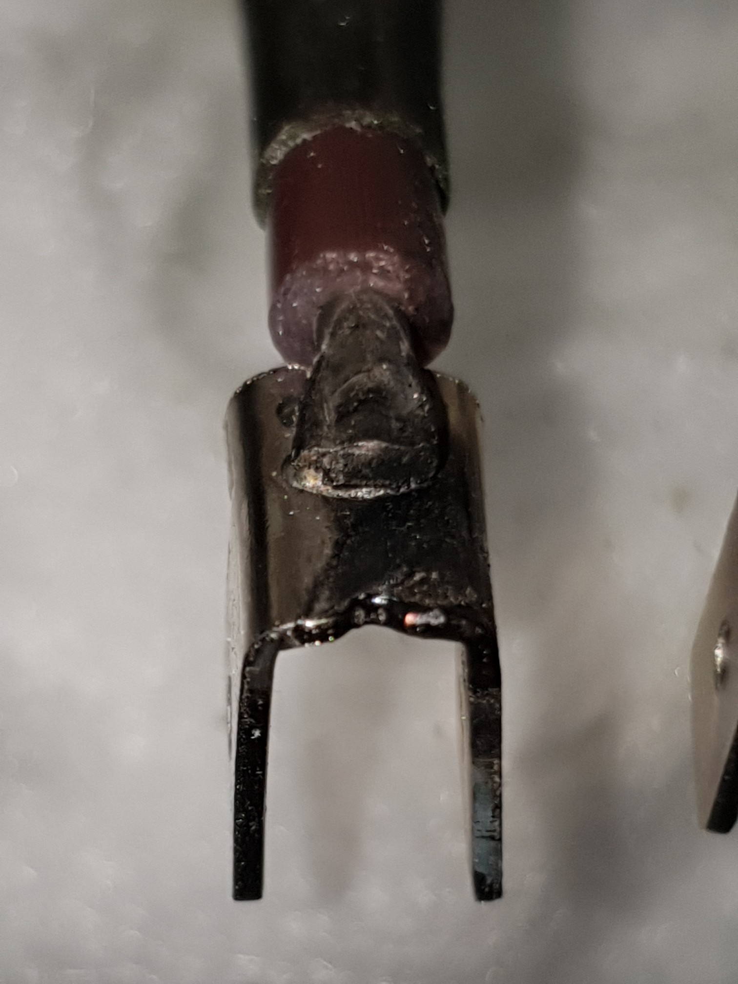

Possibly found the culprit??
Checking all the elements with a megger, across the grill element blade to blade is 57, either blade to earth blade is zero.
Then noticed some blackening on one blade...

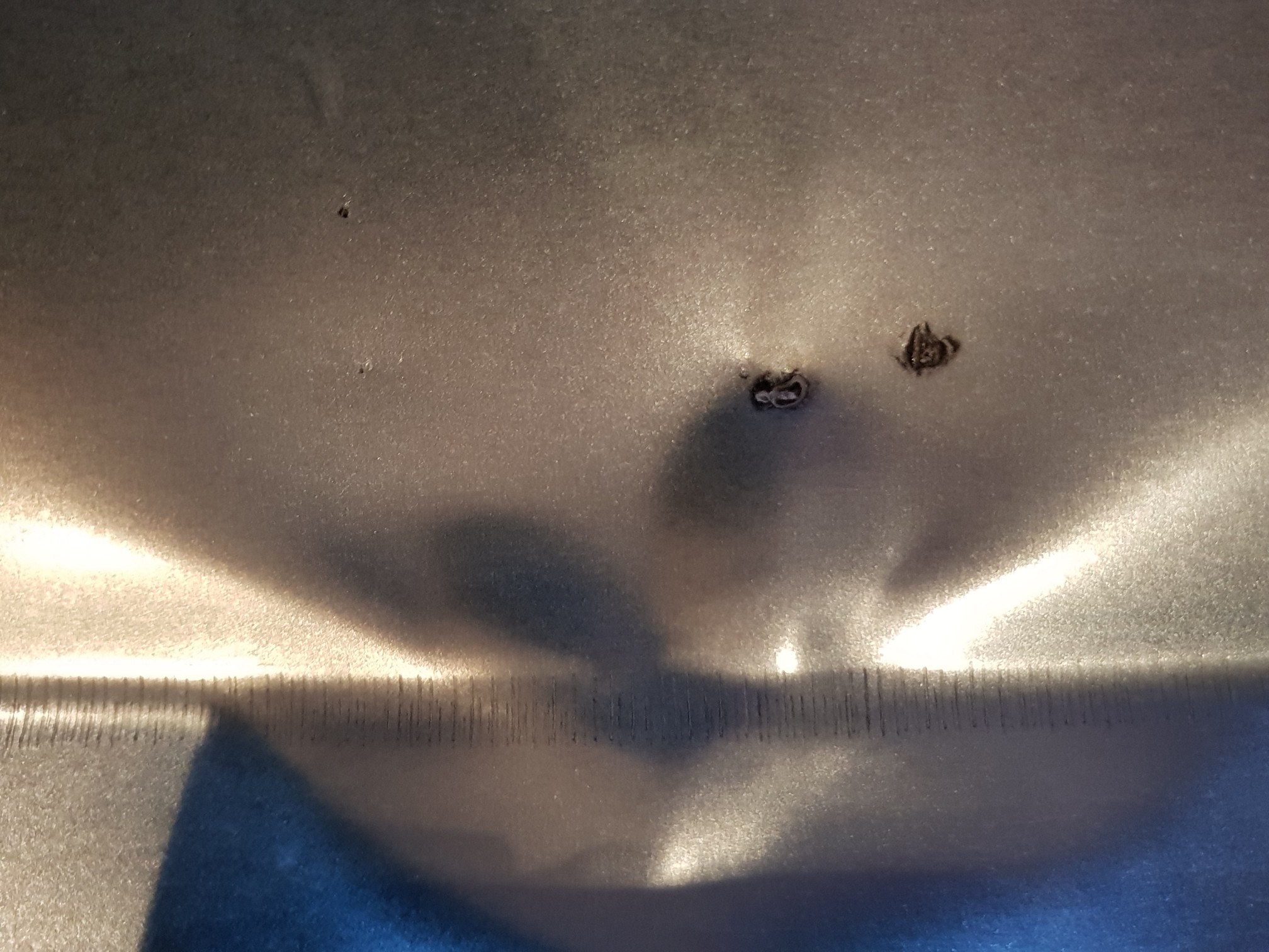

Whatever it is you need to be sure that you have found it - otherwise you risk it happening again.
Yes my money is on casing as well.
We bought a "seconds" oven cheap that was all dented on the external panels, goodness knows how looked like a fight with a fork lift.
I took all the flimsy back and bottom panels off and straightened as best I could and inspected before powering the thing up for the first time. Inside was very similar to yours apart from without the blackening in my case.
