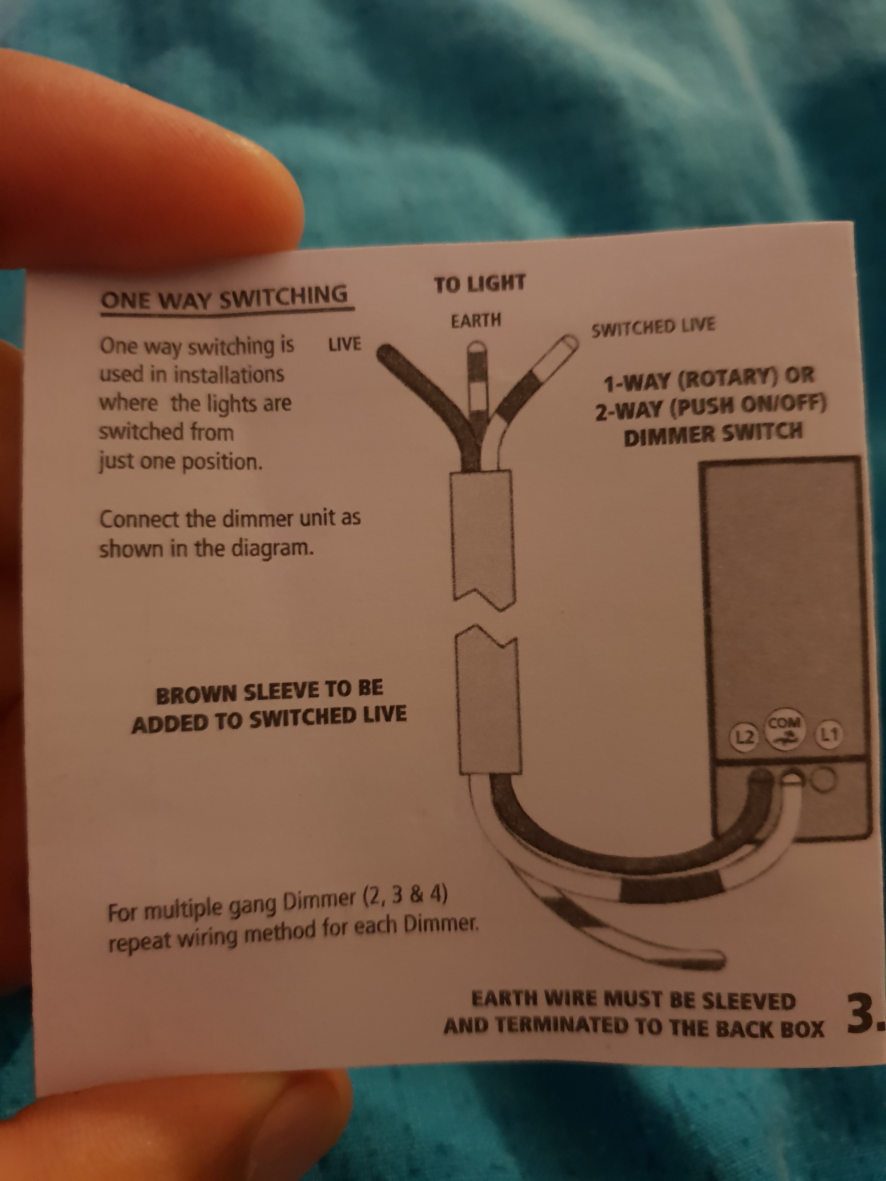

I want to tackle swapping a single light switch in my kids bedroom from standard switch to dimmer switch. I bought a dimmer switch, 25m back box and a dimmer led light bulb. All the videos ive seen and forums ive read, the brown or red live wire goes in the centre common terminal and the neutral black or blue wire goes in L1. Is this correct?
Now what has thrown me is the wiring instructions with the dimmer switch give contradicing information? Looks like live going in L2 and neutral in common terminal, this cant be right? See attached picture.
Pls advise thankz Ice
If you only have two wires at your switch both are live so connect one to Com and the other to one of the L terminals, doesn't matter which way round as long as one is in Com. Can you show a pic of the wires at the switch to confirm.
Ok. For a start, you don’t have a neutral connected to a switch. If there’s a blue, or a black it should be sleeved with brown or red to distinguish it as a switched live.
Is there only 2 wires at the switch? A photograph of the existing switches connections would be handy.
One wire goes to com, the other goes to either L1 or L2.
Please isolate the circuit at the consumer unit before unscrewing the switch from the wall.

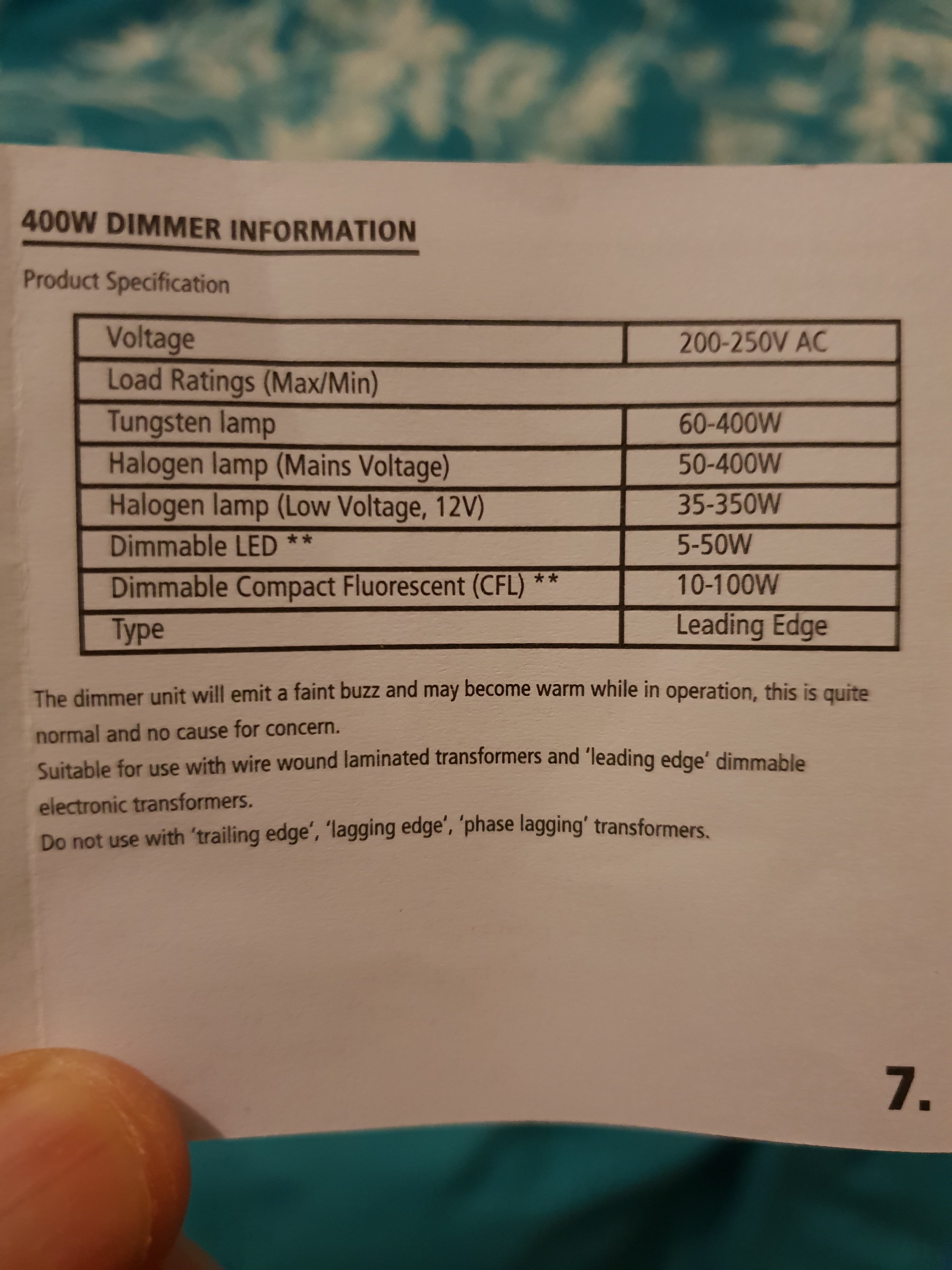

But seriously, if you didnt get a dimmer that is specifically for LEDs, then you may have problems.
Then you are ok for that load.
Please don’t get confused by this
15w equates to 100w output but not 100w load. ?
Lamp manufacturers state something like this to give your average punter some idea of the equivalent light output. What they mean that the light output of their 15w LED lamp is similar to what you might be expecting from one of the old style 100w bulbs.
To try and get away from this comparison, lamps are quoted as LUMENS. This is the amount of light output.
This is better, because the LUMEN output of a 15watt warm white LED lamp is vastly different to the LUMEN output of a 15watt cool white LED lamp.
