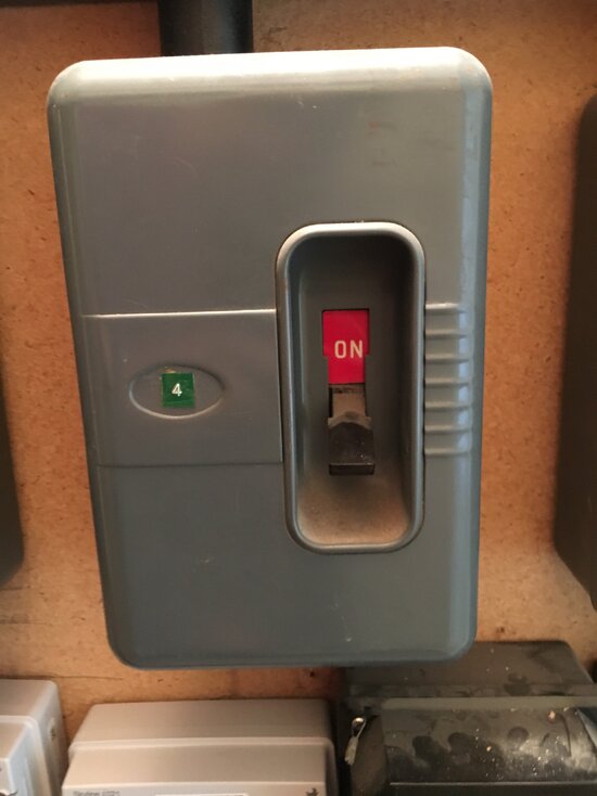

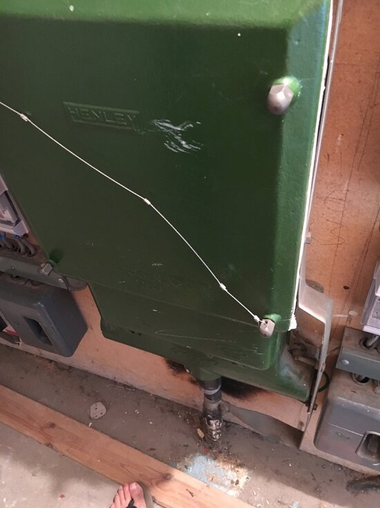

Hi all, NICEIC are coming back a.m. to see me for AC upgrade but I have a small problem, as they saw two big jobs last time 3wks ago or less, I can use my place CU upgrade & move for the job this time, problem being I've got EIC for the works I've done and all on RCBO's now but on iCertifi I need supply parameters and origin details. I'm a little stuck here as got Ze at my cu inc PEFC & PSSC but mains room serves 12 flats, is TN-S and through a BS5419 switch fuse which I think is 60A rewirable fuse inside carrier but do I need to do Ze from the DNO line in there to a disconnected main earth from them ? & if so as I can't kill power down there at switch to get cover off or what do I do ? Would we always need to go right to source like this when this kind of arrangement is supplying say flats or HMO's? Also need to find a kA rating on the old fuse down there ?

No reason why you cant look in the switch is there as it is almost certainly a 3036 and if it is 60A on a 16.0 T&E that could be a problem.
No reason why you look in the switch is there as it is almost certainly a 3036 and if it is 60A on a 16.0 T&E that could be a problem.
So even those big buggers are still 3036 like the teeny board rewirables ? Just smashed big toe nail off so nothing much to cut off lol

He went over everything and including the twin and earth sub, but told me that due to all flats being bonded to a gas main riser ( no longer in use but extraneous ) and main water and with all the flats being run in 16mm sq that the 6mm would be fine as there are effectively a large system of parallel paths down to earth and that there are no thermal effect issues of the existing cpc.
