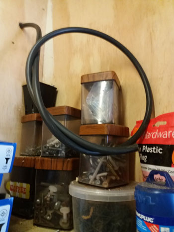

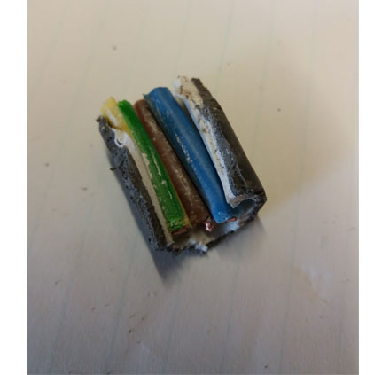

Wow, I am surprised, not many of us out there that know how to gland off micc cable now days. Seems a surprising choice of cable for a domestic setting.
