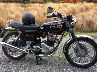

Hi I am new to the forum I have a problem with a Norton it has electronic ignition and is positive earth when I engage the starter the voltage drops which is to be expected, the problem is the electronic ignition needs the full 12V to operate normally this causes a lot of cranking to start whereas one kick and it starts. I bought a small voltage regulator which puts out 12V even when the input voltage drops to 8V however it is Neg ground so can't see a way of using it. In your opinion would a capacitor in the feed wire to the electronic ignition solve the problem many thanks

And get a photo of the bike on here for us to have a look at it!

Lovely bike.
