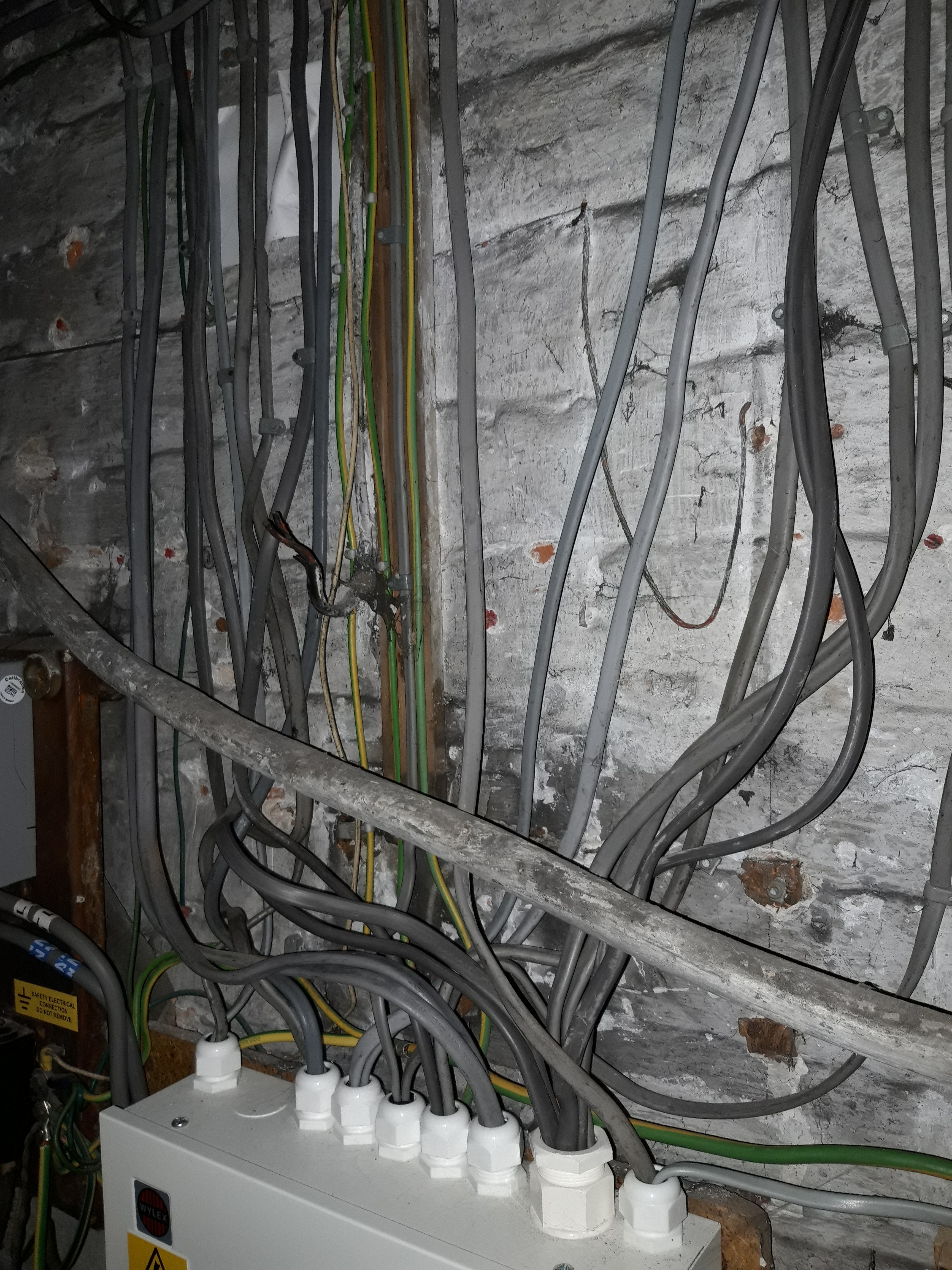

Simple enough job, three additional DSOs in existing ring to avoid the use of extensions and multi plugs.
First things first quick Zs on socket, 0.31 Ohmos, lovely....
...Check cut out and main fuse,

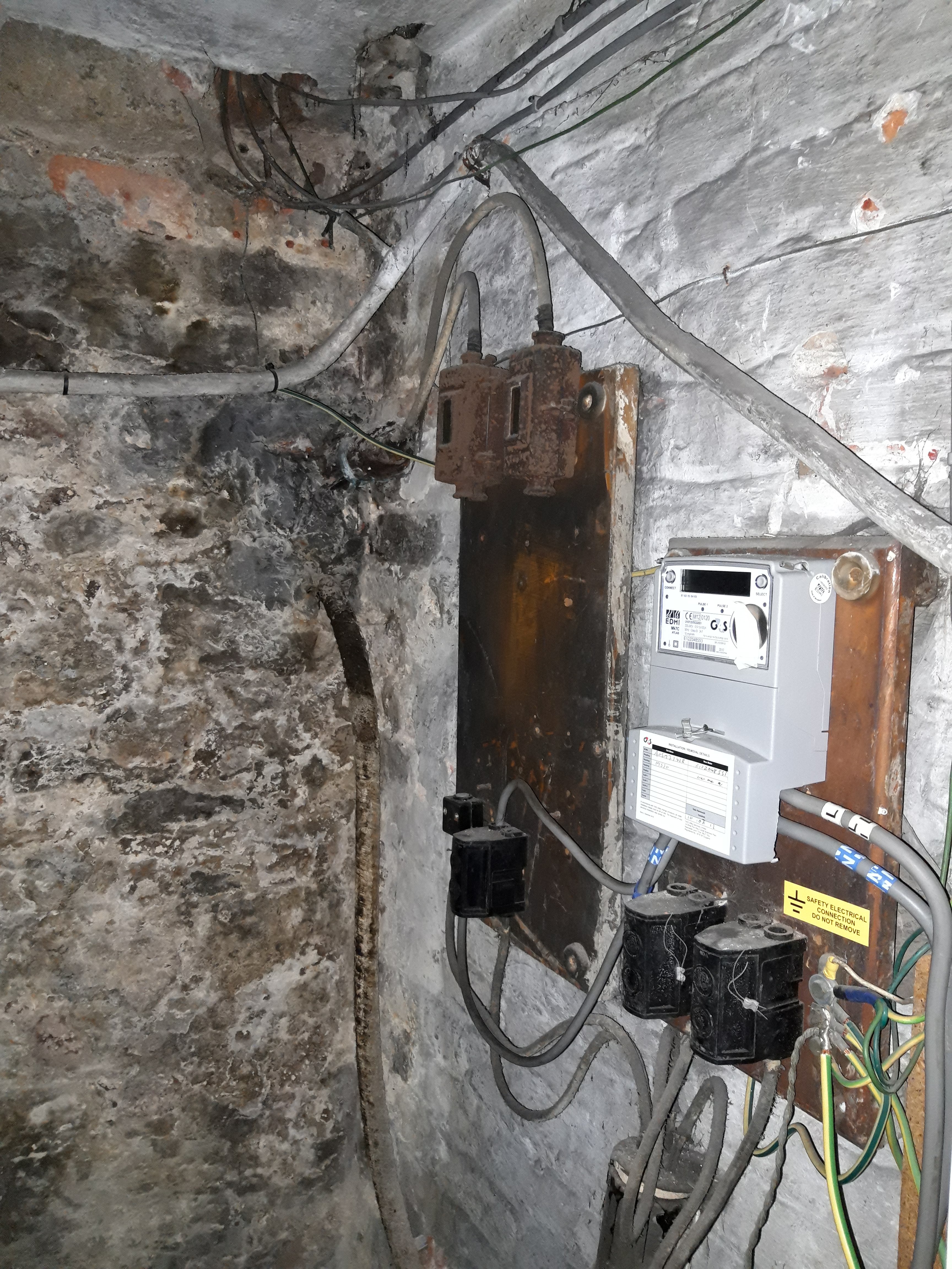

IS there anyone on this forum who was alive when this was installed?

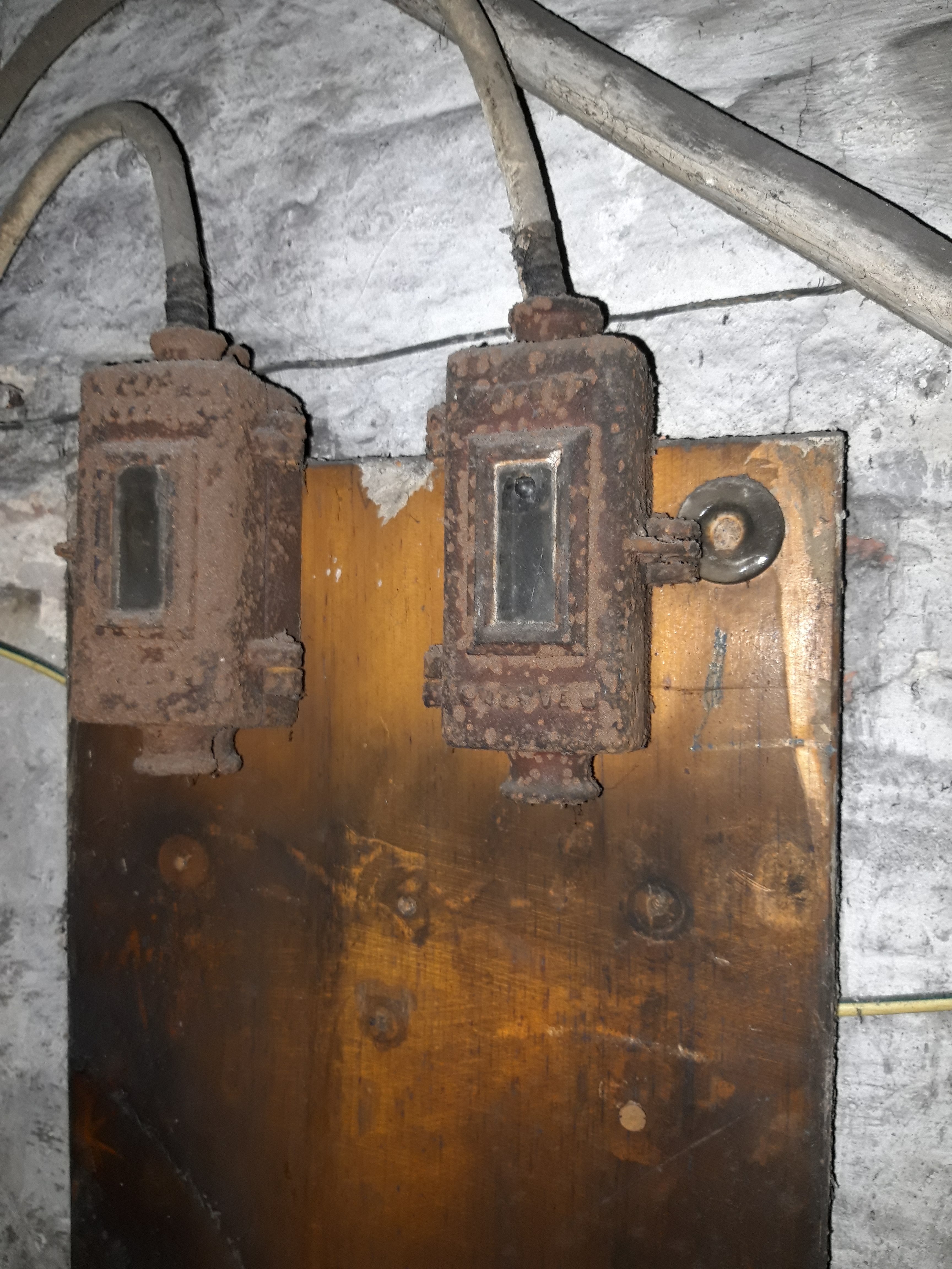

No tingle using the lick test but it looks a bit iffy.
Everything tested fine and job completed but as title, would you make a note on the EIC contact DNO to have this reviewed/renewed.
Also those fuse holders state 60Amps which is some going considering the load on the single phase in use.
Some other interesting bits.
