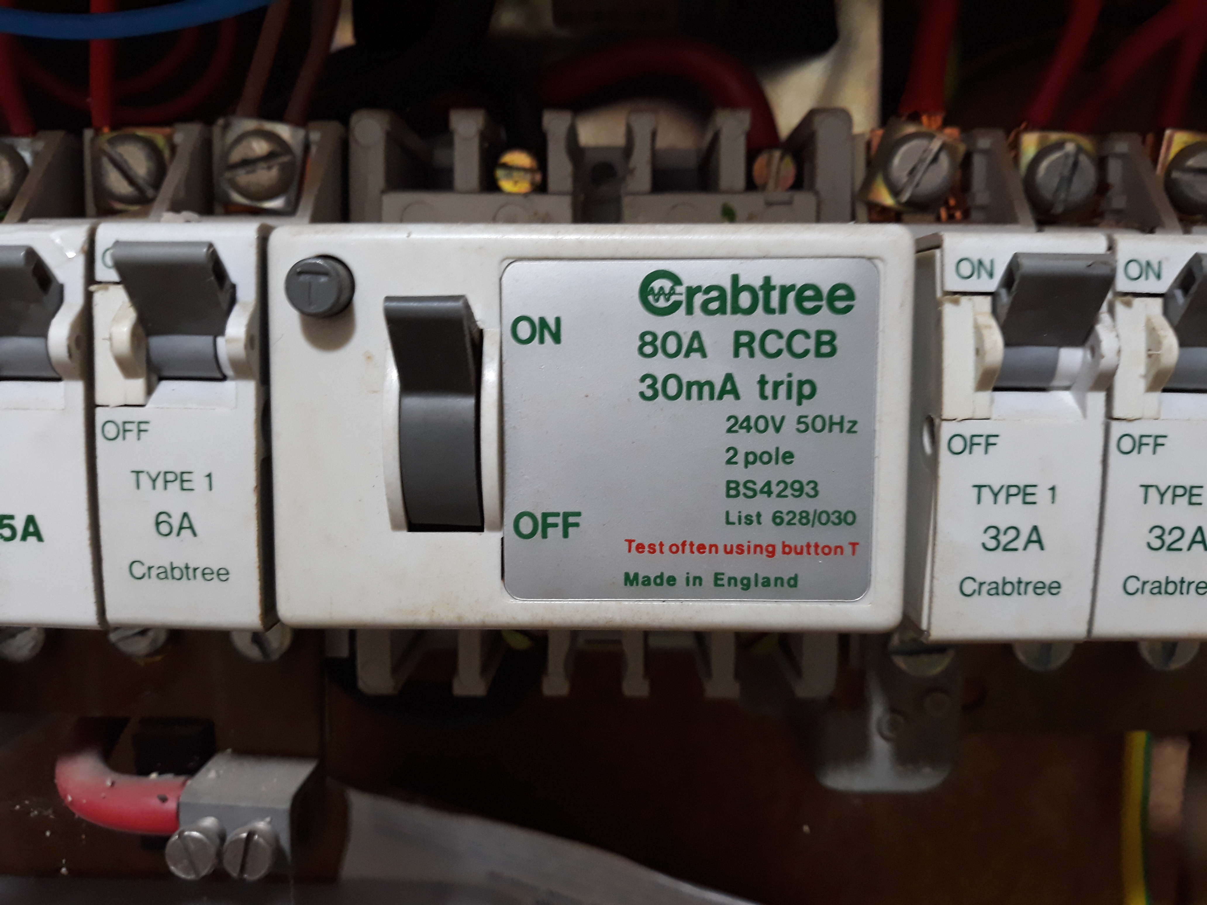

This looks like a Crabtree consumer unit that I fitted in the 80's made from the hard plastic.do you know the name of the board ?. One option if you speak with Crabtree if the bus-bar is the same to fit a newer type in. The new type could be the same footprint to fit in or they should be able to tell you what it is from your photo.
I can see some 63A 30ma on eBay, I wouldn't have thought it would be an issue to be less than 80A.
around £50 is the issue for a 2nd hand part. £10 more can buy a dual RCD BG CU>
