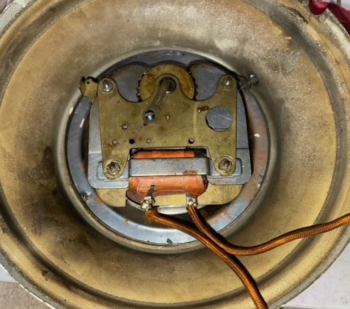

I accept this is an unusual post!
This clock has been in a family since early 1930's, the owners grandfather acquired it and fitted it for his mother. (Folk law is that it was one of the first electric clocks in Coventry, but who knows.)
I've been asked if it could be put into use again. As I rather like mad projects I said I'd have a look at it.
I've tested the coil resistance, and IR tested both sides of coil to metal case and was satisfied that it wasn't an instant electrical death trap. But it didn't work, even manually trying to get the motor to take. The motor wasn't moving freely so I've had it largely to bits, cleaned and oiled what I could, got it back together again (that is the truly amazing bit) and now to my delight it actually works.
Therefore the question is, what is the best was to connect a metal cased simple clock to a modern supply. Clock points are not really in abundance in houses these days.
Could it be as simple as a suitable grommet, flex, and plug with 1 amp fuse, and would you find a way to earth the casing? Other suggestions most welcome.
Old Electric clock, best/safest way to connect? 1662401480348 - EletriciansForums.net
Old Electric clock, best/safest way to connect? 1662401569555 - EletriciansForums.net
Old Electric clock, best/safest way to connect? 1662401521355 - EletriciansForums.net
Old Electric clock, best/safest way to connect? 1662401605100 - EletriciansForums.net

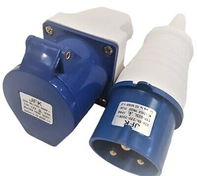

I'd personally got down the route of earthing the casing and feeding from a low amp fuse. If you could get a cable gland that would be ideal, but it doesn't look easy. Along as the connections Re covered and there is some method of securing the outer sheath then I can't seeca problem.
Nice to see it being kept in use.

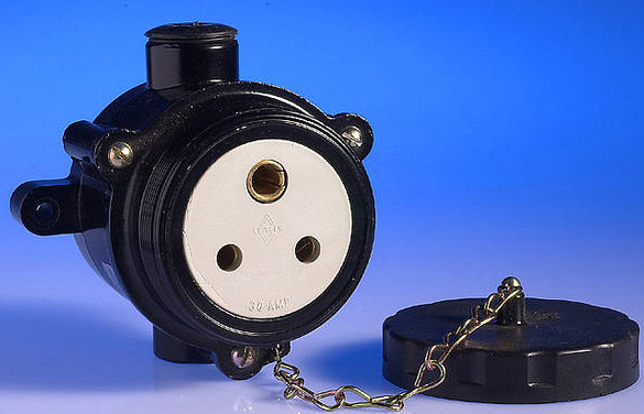

Actually I should run a separate earth and use one of these beauties:
Old Electric clock, best/safest way to connect? 1662452560035 - EletriciansForums.net
