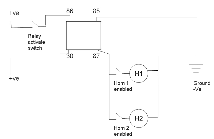

Hello everyone,
I'm just wondering if I will be able to connect two horns both 15amps on one 30 amp relay but connected in parallel so I can operate the horns separately. So it'll be positive to the relay, then one switch to activate relay, with the two horns each with separate switches and then connected to negative. I would include a diagram but for some reason its not letting me upload it. Any help would be much appreciated!

Hi welcome to the forum.
I assume you are talking about car electrics here.
If the horns actually do take 15 amps each then a 30 amp relay may be a bit close to the wire, as if both run they may overload the relay. Usually the rating is the max the relay can take and in different circumstances they may be lower rated.
However 15A is very high for a car horn that can be as low as 1A.
Can't quite follow the wiring description but parallel from the relay outputs would be the way to go.
Awesome thank you and yeah it will be car electrics but I wouldn't operate the horns at the same time, I'll try and get a diagram up later on in the week hopefully it'll make more sense
Something like this?
One relay two horns? dual horn relay - EletriciansForums.net
Though you would need to select the horn you wanted to use first and if none were switched there would be no horn!
possibly a 1/2 selector switch for the horns would be better, this would avoid running both together but ensure one was always on.
