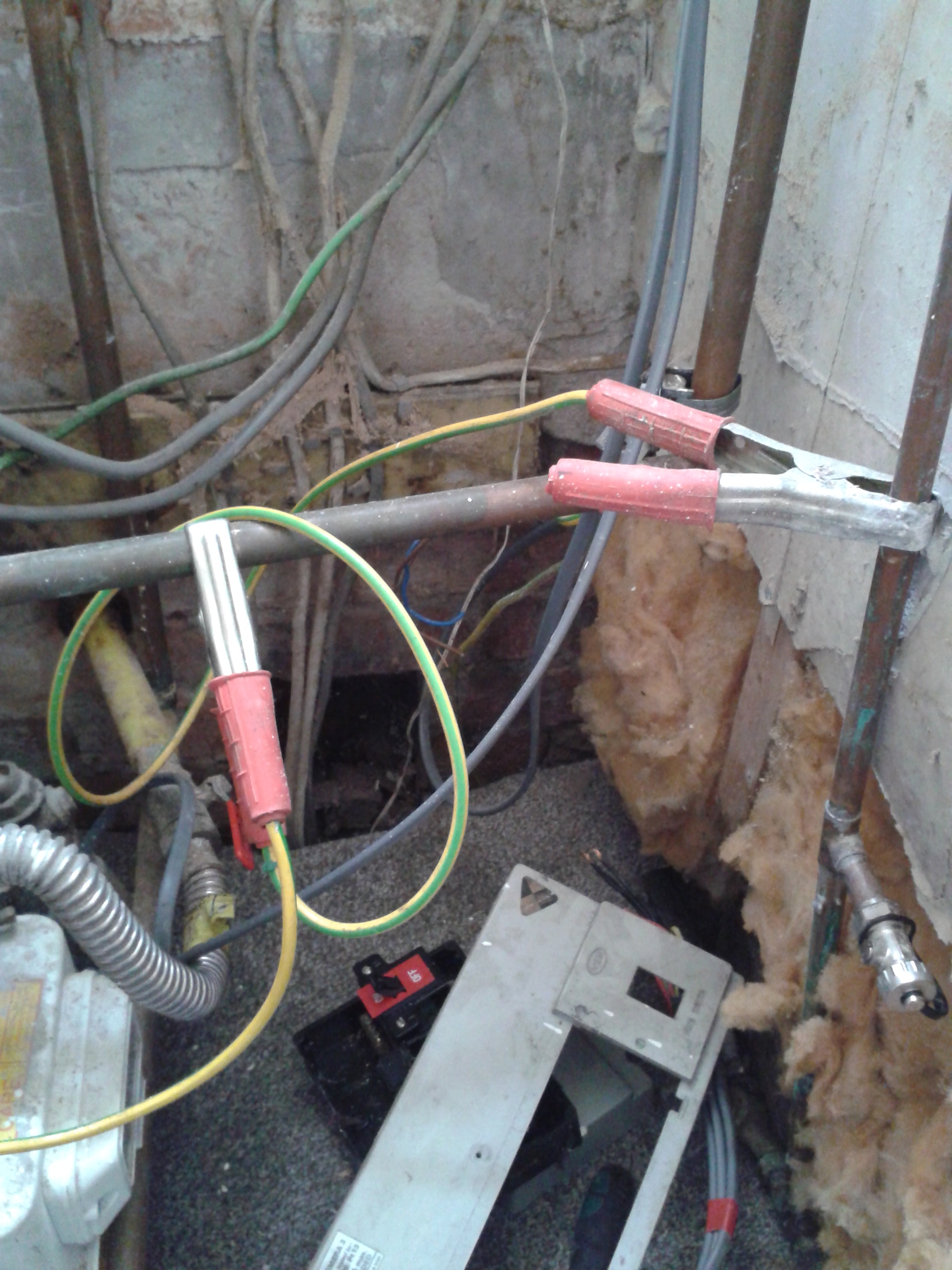

I was changing the consumer unit today and look how the previous person has earthed the main water and gas!
One way of earthing the pipes..... 20171113_105334 - EletriciansForums.net
I will give them 10 out 10 for ingenuity:confused:

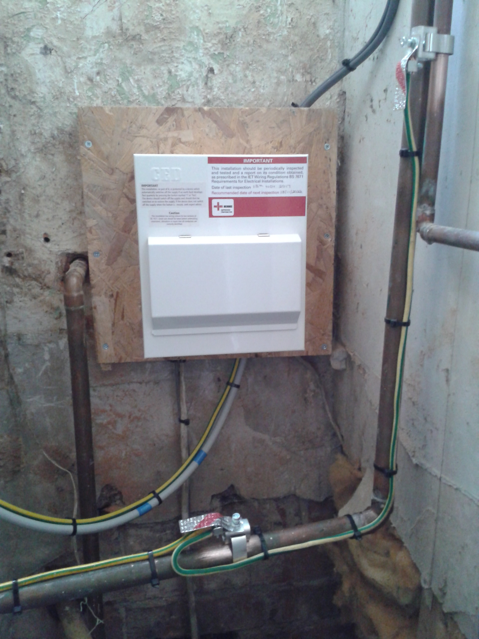

Here's how it looked after i had finished.

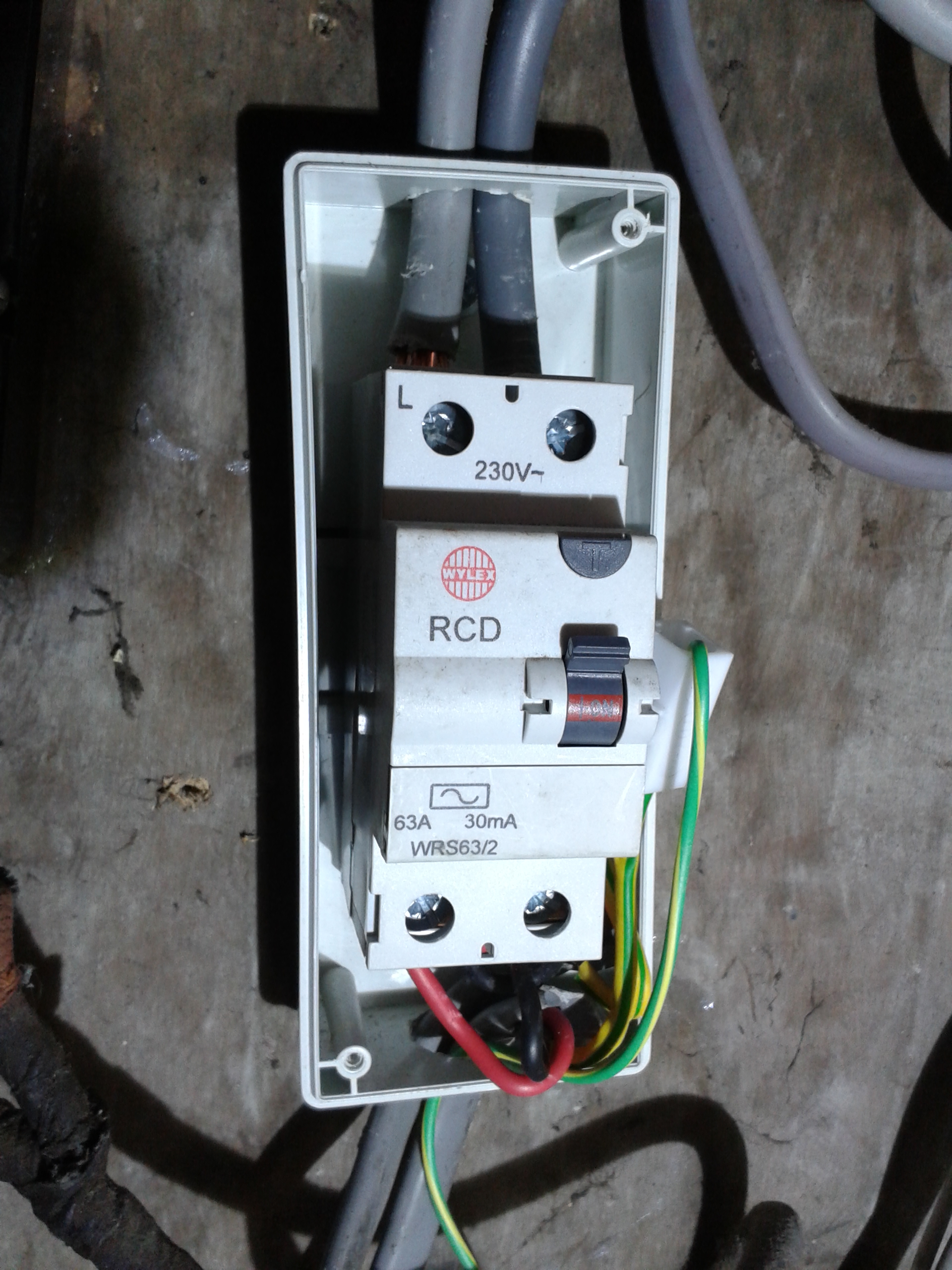

On a totally different job i was called out to i came across this fitted by a so called electrician.
One way of earthing the pipes..... 20171108_135012 - EletriciansForums.net
The bottom of the rcd is feeding straight out to the RFC.
How he thought that a 63amp RCD on it's own would comply with regulations is beyond me.I had to removed the enclosure and fit a larger one so that i could fit a 32 amp mcb next to the RCD as it needed.
The guy even charged £330 just to fit that unit!
It saddens me that cowboys like this get away with it and tarnish qualified electricians in the process.:mad:
That looks like a really good job. Amazing what some people do. Wonder if they are even electricians or just go under the title.
CPC came out of the bottom of the unit directly into the main earth bar.CPC was a single piece of 1.5mm green/yellow which then connected into the ring cpc's via a 15amp connector seen to the right of the photo.
Never been pulled before for tie wrapping the bonding wires and i've done it for numerous inspections before.What harm can it do.They aren't hot or don't move so i cannot see the problem?
The NIC did issue guidance on this very thing some time ago, I only have the BRB to hand so the reg number may have changed, but 528.3.3 (proximity to non-electrical services) basically states that where an electrical service is in close proximity to another service it shall be arranged that work on that service does not affect the electrical service. I suspect that is the reg that applies.
Not a criticism at all Bob but with the meter tails going in through the rear and not glanded I'd secure then with clips or small cleats.
Cheers mate.The tails are cleated at the back of the board before i fitted it so they aren't going anywhere;)
Is there a definite regulation about not tie wrapping bonding cables to the pipes anywhere?
I can understand not tie wrapping t&e cables but bonding cables?
Other services should not to be used to support our cables
Besides,what would your reaction be if he started strapping his pipes to any cables that happened to be handy instead of using his own clips for support :eek::)
