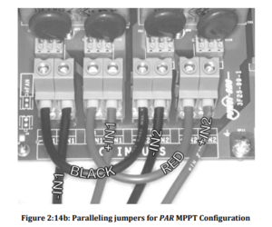

Thanks @marconi,
I think, the independent or parallel mode MPPT on this Solis inverter is similar to the independent or parallel mode MPPT on this PowerOne inverter. https://powertripenergy.com/wp-content/uploads/Power-One-PVI-3.0-3.6-4.2-manual.pdf
Please help me clarify this, if this is true, then the limit current increases to around 11A x 2 = 22 A, but the total power input PV shall not exceed recommended max. PV power for solis inverter.
and I also haven't gotten an answer from the Solis helpdesk

@heri1177
I don't have experience with Solis inverter but I run Sofar hybrid inverter with 2 mppt configured in parallel. It's 1 string connected to both mppt channels with Y splitter. This allows to run at full voltage per each channel but half the current
@kropaske
What type/series is the Sofar inverter?
1 string panel with Y splitter to both (dual) mppt, it looks like your inverter can parallel MPPT mode, can you share a photo of PV monitoring of both mppt from the inverter. Thanks
