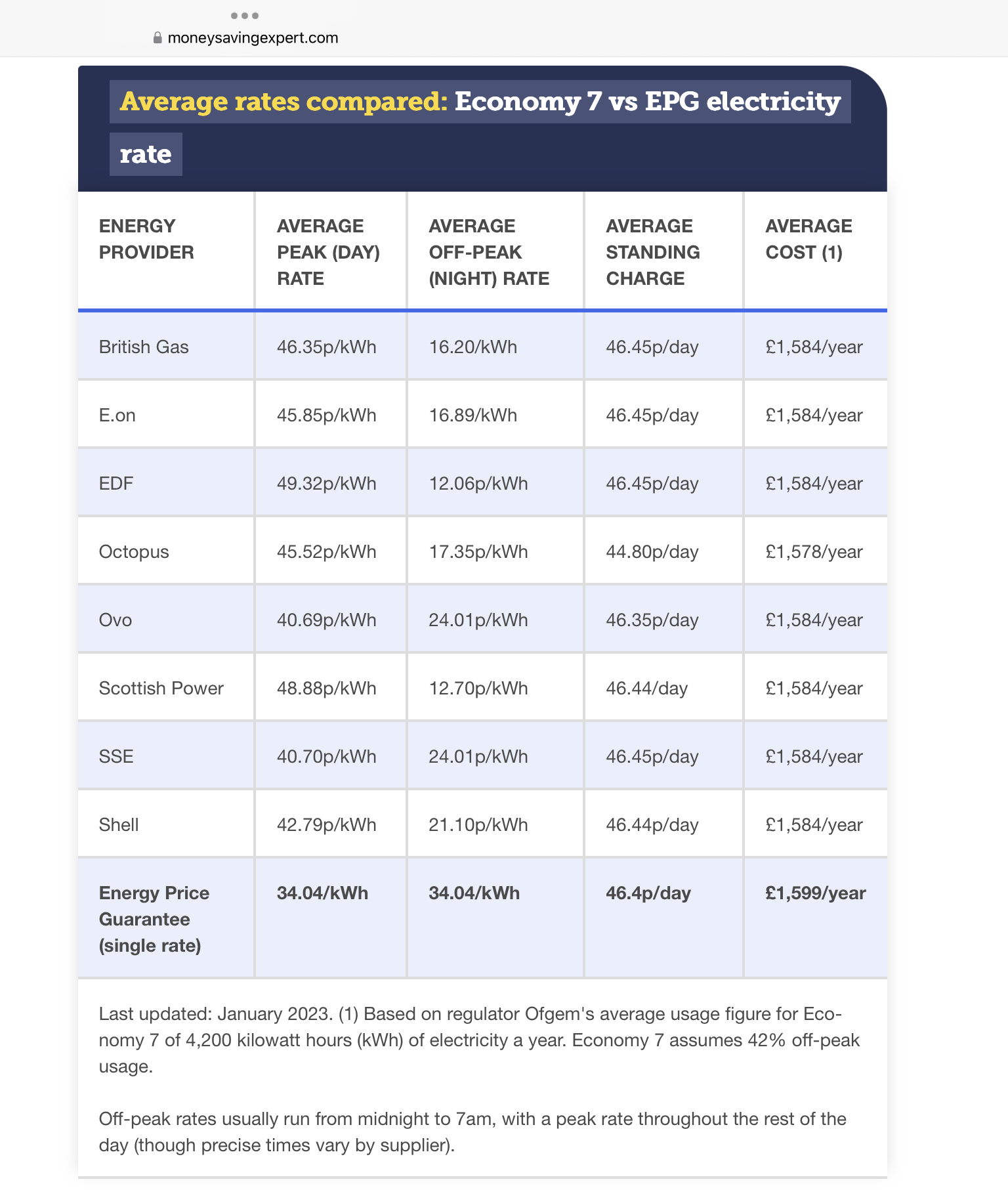

Your bill shows you are on a single rate tariff of 38p a kiloWatthour with no cheaper rate periods at night or during the day.
Do you have electric space heating?
Photo attached of the meter. Does this help?
Can I ask British Gas to add me to the E7? or how is this done?

Nicole: Thank you for your last post. You are clearly exasperated and who wouldn't be. I'll explain what I think is the situation at the moment.
1. Your flat relies on electricity for space and water heating. To be most economic you need to be on a dual rate electricity tariff such as Economy 7 or Economy 10. These provide periods of cheaper rate electricity. Time switches are used to turn the space heating and water heating on and off to utilise the cheaper rate periods. At the moment you do not have a dual rate tariff. I believe you 'lost' a dual rate tariff when you swapped from the pre-payment meter to a credit meter with British Gas.
2. Your hot water tank has two elements, the bottom one to use cheaper rate electricity and the top one as a boost using whatever tariff is operating when it is on. What I cannot know now is whether the time switch to the left of the Delta Dore controller was for the bottom element to switch it on during cheap rate; the top element being then simply controlled manually by the left hand 'Water Heater' switch - you'd have to remember to turn it on and off.
3. I reckon though that the time switch to the left of the Delta Dore is for the top element as it is used now. The bottom element was then being switched on and off for the cheap rate by the old prepayment meter. There is a hint to this set up by the thinner brown grey vertical wire going into the brown plastic box with 'PROTEUS' written on it. I believe it previously went into your old prepayment meter. But since your change to a credit meter, which does not have an output which switches on and off during cheap rate, it has been connected to the brown box which now provides a permanently on supply for the bottom element. The bottom element is now only being controlled manually by the right hand 'Night Immersion Heater' switch. Thus, the change from prepayment to credit meter has resulted in no time control of the bottom element meaning it has been on constantly albeit regulated in temperature by its thermostat. Meter change men/women are not obliged to ensure any downstream effects of the meter change are attended to. So since your meter change I believe - perhaps you can confirm from experience - the top element has been controlled on/off by the time switch left of the Delta Dora and the bottom element has been on permanently if its switch is on.
4. Now, I may not have the full history of this panel correct because one can see a square white plastic blank fitting bottom left below the 'Immersion Heater' switch. It may have once had a square timer here which looks like this:
