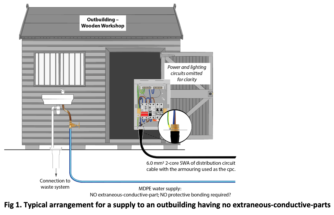

Supplies to an outbuilding via steel-wire armoured cable
An outbuilding supplied from the origin in the main building via a 6 mm2 two-core steel-wire armoured (SWA) cable having copper conductors and 90 °C thermosetting insulation, clipped direct. The cable is protected by a 32 A Type-B circuit-breaker. The conductor size was chosen to address any potential voltage drop issues.
Adequacy of armour to serve as the circuit protective conductor

Adequacy of armour to serve as the main protective bonding conductor where there are no extraneous-conductive-parts present
If the outbuilding does not contain any extraneous-conductive-parts, there is no requirement for main protective bonding to be provided (See Fig 1).

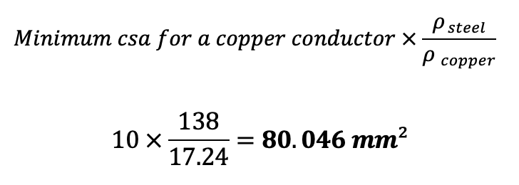

From Table 54.8 of BS 7671, for a 35 mm² PEN conductor, the copper equivalent csa of the main protective bonding conductor must be not less than 10 mm².
From BS EN 13602: 2013, the resistivity (p) for copper is 17.24mΩ/m.
From BS EN 10257-1: 2011, the resistivity (p) for steel 138 mΩ/m.

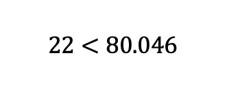

The csa of the steel wire armouring is calculated using:
As stated earlier, From Table G2 of BS 5467: 2016, the csa of the armouring for two-core 6 mm² cable is 22 mm².
As such, it can be seen that the armouring of this cable is not sufficient to act as a main protective bonding conductor.
Referring again to Table G2, for the armouring to be adequate, a two-core cable having 50 mm² circular conductors and armour csa of 86 mm² would be required. This is an unrealistic proposition for the application.
