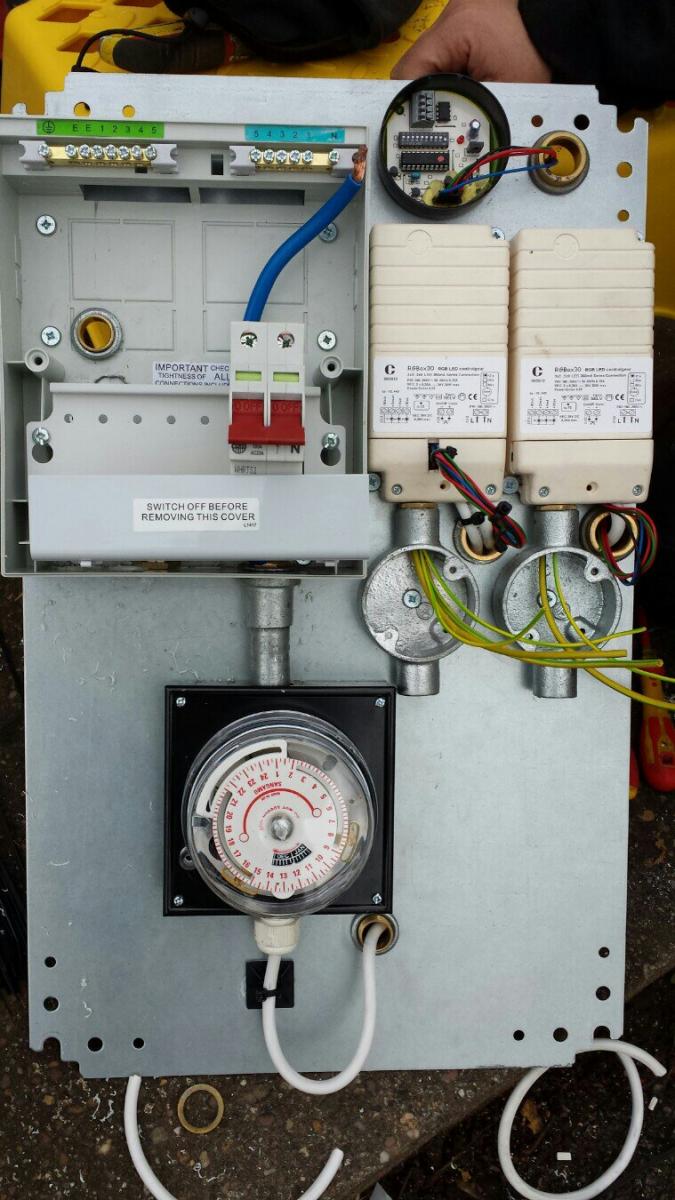

In the middle of a lighting job at the min colour changing ground lights. Collingwood will design for you this is todays pic not finished yet so don't judge just
I'm old school. Sangamo = bomb proof. But to be honest there is a digital controler low level closer to the lighting which changes the colours for special occasions such as Christmas and remembrance day as this installation is at a war memorial. Been an on going job for a while.
Yeah there still around. I pretty much guarantee the lights will pack up long before the timer week. Because it's a war memorial there isn't really much budget for ongoing maintenance so they've gone for reliable over looks. But the lights are really smart and have a min 18000 hour life. Should last a few years.
