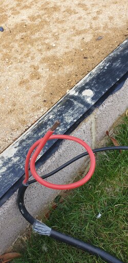

Hi all, thanks for your replies. I should have included some pictures to get started with, I should have thought that through. I should not have decided to write the post at 3am, by 8 core I was referring to the strands within the cable which is largely irrelevant and not quite sure why I bothered to write that, what I should have said is its 2 core 4mm cable. I am certainly not stupid enough to mistake cat 5 for armored cable ;) From my understanding the 4mm cable has a 40+ amp rating and should be enough to run the outbuilding from without having to dig up the entire garden which would be good to avoid, but I am happy to be corrected!
Equipment running within the office will be two computers, 5 monitors, led lighting and an electric panel heater (Which will most likely be a 1000w model).

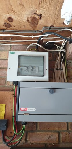

The reason I am asking about how the plug is wired is to me it seems an odd way to do it but given the previous owner of the house (claimed) to be an electrician I wondered if there was reason behind it or it was just some quick hack. The plug is not in a useful place and can be replaced with a junction box happily if that is a better approach. Prior to turning off the outdoor circuit the plug was in working order as were the plugs within the shed which has now been removed. The plug is not easily reached as its nested away behind a bamboo plant but it is an RCD outdoor switch which resembles the attached picture. Also attached is a picture of the cable and where it connects up in the garage.
The Crabtree CU already has a RCD for the circuit, so not sure why the socket has RCD as well.
Is the cable connected to the 16A breaker?
What does the 10A RCBO connect to?
They are both turned off.

The cable is connected to the the B16, the B10 is connected to some underfloor heating in the kitchen. Both of which as you say are turned off and have been for some time. The run is 25m.

Thanks for all your replies, really appreciate it. Yeah, the full run from the garage to the socket and from the socket to where the office is being built is all 4mm SWA. The shed is no longer there the cable in the picture is where it currently surfaces and if sufficient is what I hope will be connected into the office.
