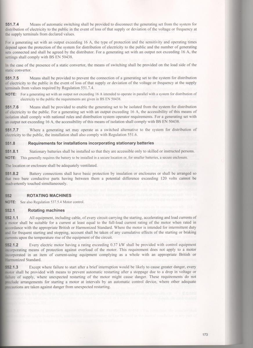

I have received a panel built by someone else as part of a build I am carrying out. Unfortunately the customer has been involved in the selection of devices and wiring requirements however i feel there are a few things a miss.
The mains incomer comes in on a 63A 16mm 5 core SY, through an unfused isolator and into a 63A C rated breaker in 16mm singles, this then goes straight in to a 63A 300mA RCD on 16mm singles. out of the bottom of the RCD is 2 off 4mm singles per phase, 1 of the 4mm is the bus main for a row of breakers which are 2 off 6a, 2 off 16A, 1 off 20 and a 40A the three phases are split over these breakers, the other 4mm from the RCD makes its way to feed a number of contactors and daisy chains from each contactor, becoming the bus wiring.
My issue, surely each circuit should be protected sufficiently to the cable sizing used, so the bus wiring should really all be capable of with standing 63A as that is what it is rated at, or does the RCD change these requirements?
my other issue is the motors only have Overloads, which in my mind only provide overload protection to the motor and therefore the only circuit protection is the MCB 63A and the RCD 63A 300mA. however some motors are fairly small and 1.0mm2 cable has been used from the overload to the terminals in the bottom for me to wire the plant to.
this means that that 1.0mm cable has a 63A breaker protecting it? and a 63A rcd, surely this is not sufficient to rely on an RCD?
In my opinion the motor circuit cables will have to melt, touch earth and then allow the RCD to trip thus being insufficient protection.
I have spent sometime in my regs book but cannot find an actual requirement for overcurrent protection on motor circuits. i have found the statement in 552.1.1 which states every circuit should be capable of carrying FLA, is this enough in my defence to get this panel returned and fixed properly.

This panel doesn't fall within the BS7671 it falls under BS60204-1 (General requirements for machinery control). Also other sub-sections of the BS60204 may be regulatory depending on what the panel controls.
BS7671 does have a few limited clauses regarding motor protection etc which mimic what is already in the BS60204.
Your Query about cable sizing is noted and what you have to take into account is this is not like a house rewire etc, many other protective measures can be used up or down stream of the main device. You will find that the majority of the time control panel loads have a fixed demand ... example the Incoming short circuit protection been covered by the MCB then the OL device on the contactor for a motor gives a fixed max limit of current that the cable could ever demand, this means the conventional fusing down isn't needed as such.

Your other queries ... the 1mm to the motors is adequate as the motor OL device protects them regardless of a RCD been in the set-up or not, depending on the make of wire the tri-rated 4mm will be rated approx 40-45amps so seems sufficient for the set-up ....again just a glimpsing observation as lack the info.

you original question is no the OL of the motors protects the cables from overload its just done downstream rather than upstream ... like netblind says if it aint EC marked and supplied with the relevant documents don't accept it, the more i look at it the more i see and the more i believe its a old hat probably mature sparks / engineer that has not keep up with times.
