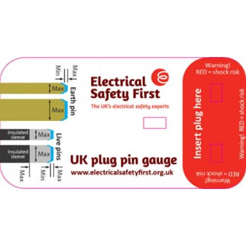

Some foreign crap has 13A fuses which should be 3A...if it's clear from the FVI that the origin is dodgy, it usually also manifests itself by undersized conductors too, and fuses that don't look right. In those cases it's a clear Fail. The worst culprits are those counterfeit extension leads that we all know and hate!

Since getting one of these I've failed quite a few cheap extension leads that managers thought would save them a few quid.
Plug checker - http://electricalsafetyfirst.instantcart.com/p/Plug-Checker_7.html
Pat testing plug fuses plug-checker-1001-7-1 - EletriciansForums.net
