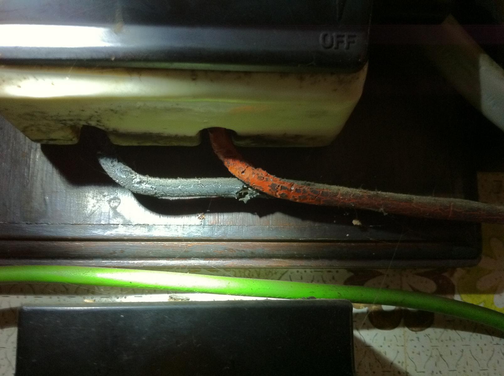

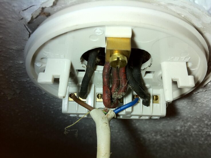

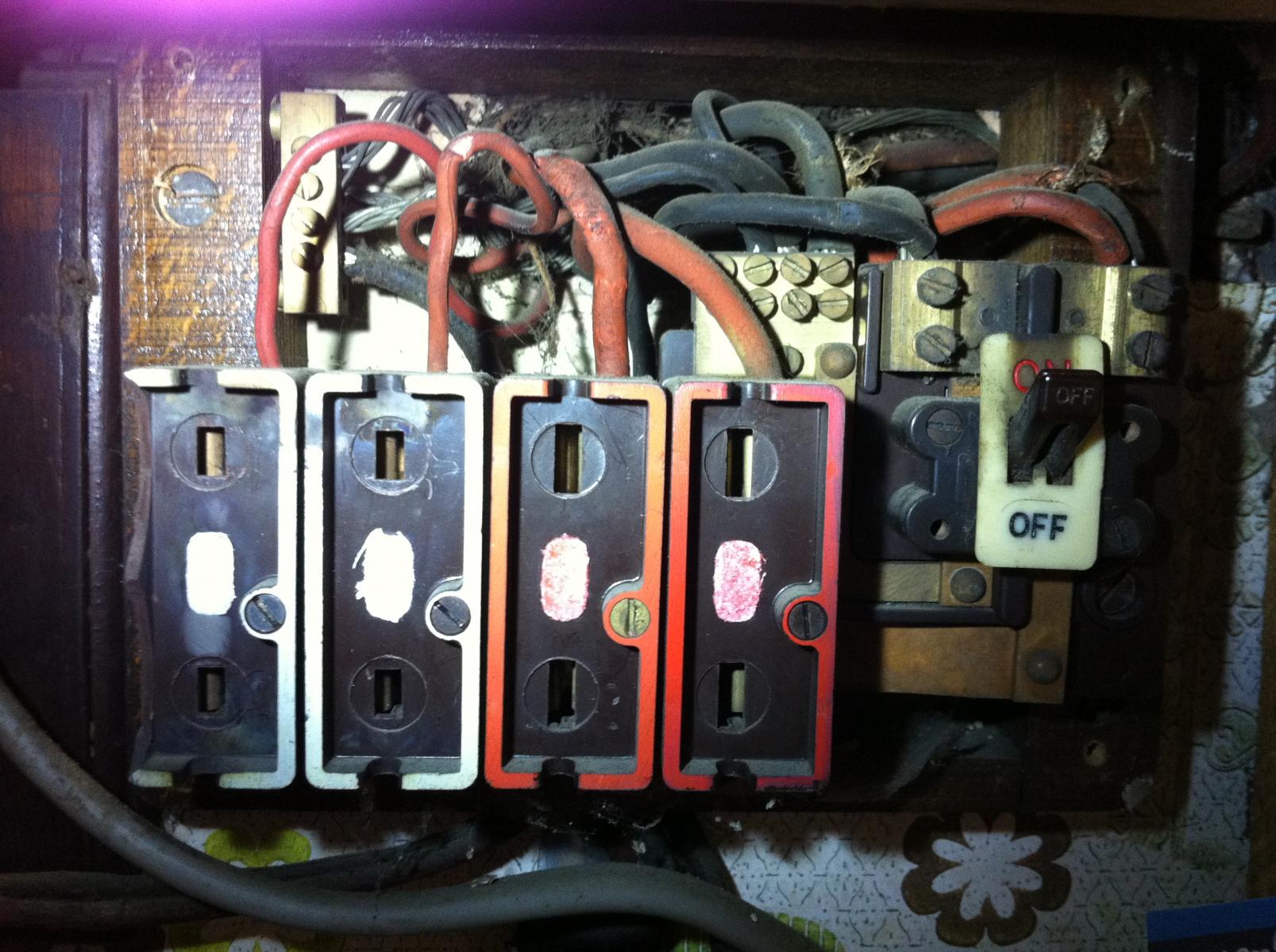

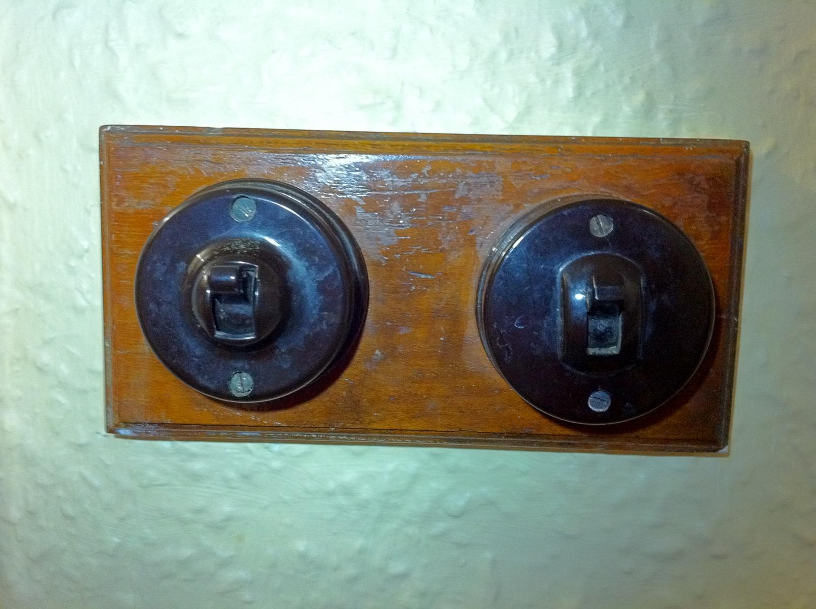

Dont you just know it when you get the call ive no earth on my sockets i would like my electrics tested , walk through the door and greeted by an elderly lady and the first thing you see is a round bakalite switches dating back to the 40's old wylex CDU with ceramic fuse holders ,VIR meter tails that crack nicly when moved, VIR cables every where kitchen sockets tapped off a VIR cooker supply wired in 2.5mm ,shower 9kw installed by a plumber 4 mm cable so sign of where its connected , old round pin sockets ,ring main installed in lounge sockets metal clad surace all wired into the lighting circuit , fuse wire for that circuit 15 amp , no cpc's in the lights metal clad fittings , house nicely decorated and then they ask is it dangerouse and illegal , argghhh where do they get the illegal bit from !!!!!!!! poor old dear got to have the house rewired top to bottom walls chased ,and her son uses the garage as a work shop supply wired in 6mm YY flex under the ground beautiful garden , and the wiring well DN had to be issued TWE cable stripped off and then wired into a light catching the garage door when opened , terminal block joining cables to gether every where no bond or RCD's broken back boxes ,cracked sockets.
hope to put a few pics up what do you do re wire asap

seriously tho advise it needs a rewire ( if you can PROVE it does) issue DN and quote as appropriate bearing in mind the elderly will allways think they are getting diddled Phone L.A. and see if there may be any assistance available to the old dear as she may not know if there are such schemes ( money for insulating her loft isnt any use if it gets burnt down is it?)

lol nice one wirepuller , i darnt even look the switches you have to remove the whole switch its the old wiring where the back wooden patress has 2 holes in it for the wires then the switch fitted over the top id never get the wires back without a bang of the insulation dropping off , i would love to just put a new CDU in for her but the condition of the cables is so poor you,d never change it and there are so many seriouse faults IE 9kw shower on a 4mm cable kitchen sockets tapped off the cooker circuit , metal clad light fittings no cpc's just one of those dont touch, rewire,changing the CDU would open up a complete wormery
Got to be done Nick and knowing you from here mate you'll do the best for her. The disruption for her will be enourmous, might just be worth having a chat with son and see if there is somewhere the old girl can go and stay.

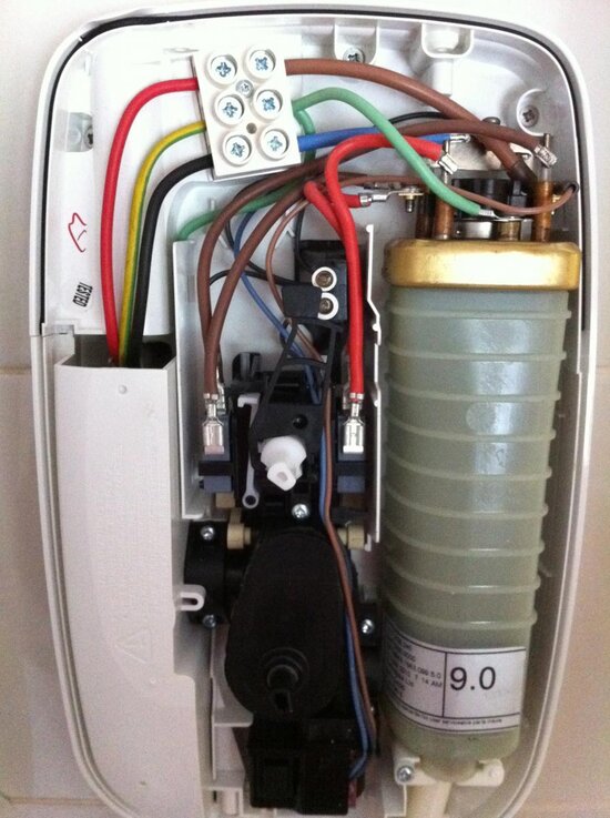

In that first pic the earth wire at the bottom of the photo looks reasonably new. Along with the shower cabling. Does that mean an "electrician" has been recently, seen the wiring in that state and moved on with no comments to the owners about at least having it tested (if it could stand the testing)?
