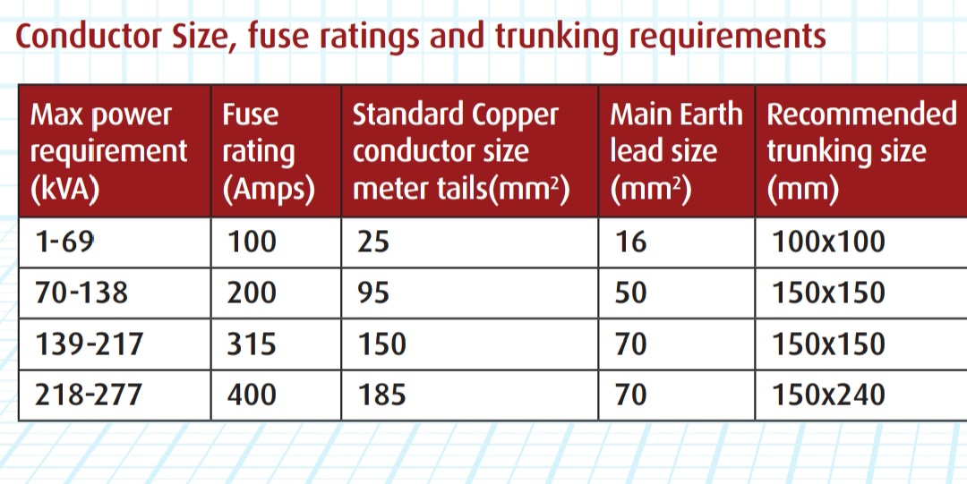

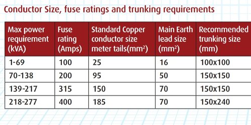

I've just had a 200kva supply put on to a new job, 315A fuses, they asked for 150mm tails, in trunking, chart they gave me is attached. Standard 70°c 6181y aswell.
It looks like they have split it up differently to most DNO.
