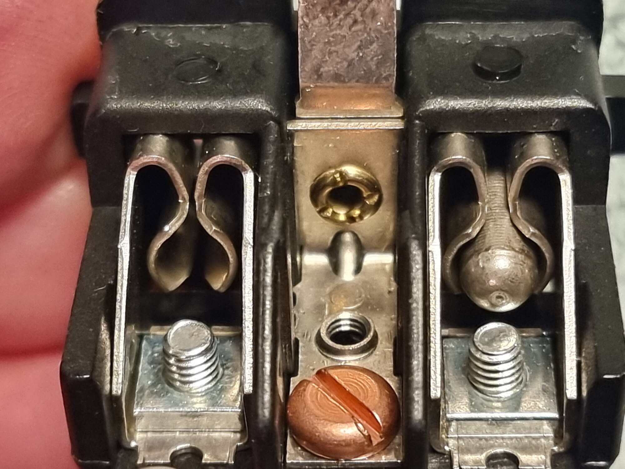

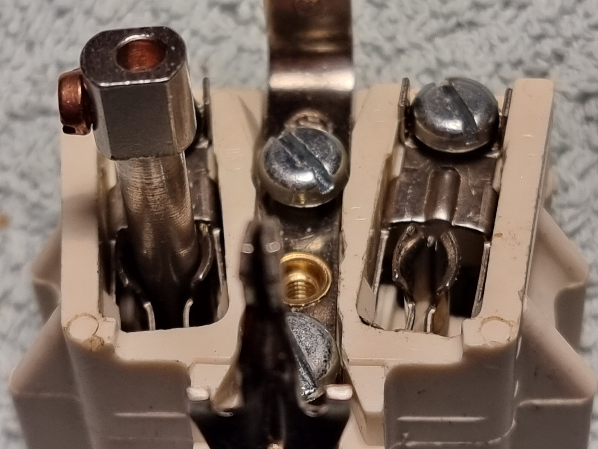

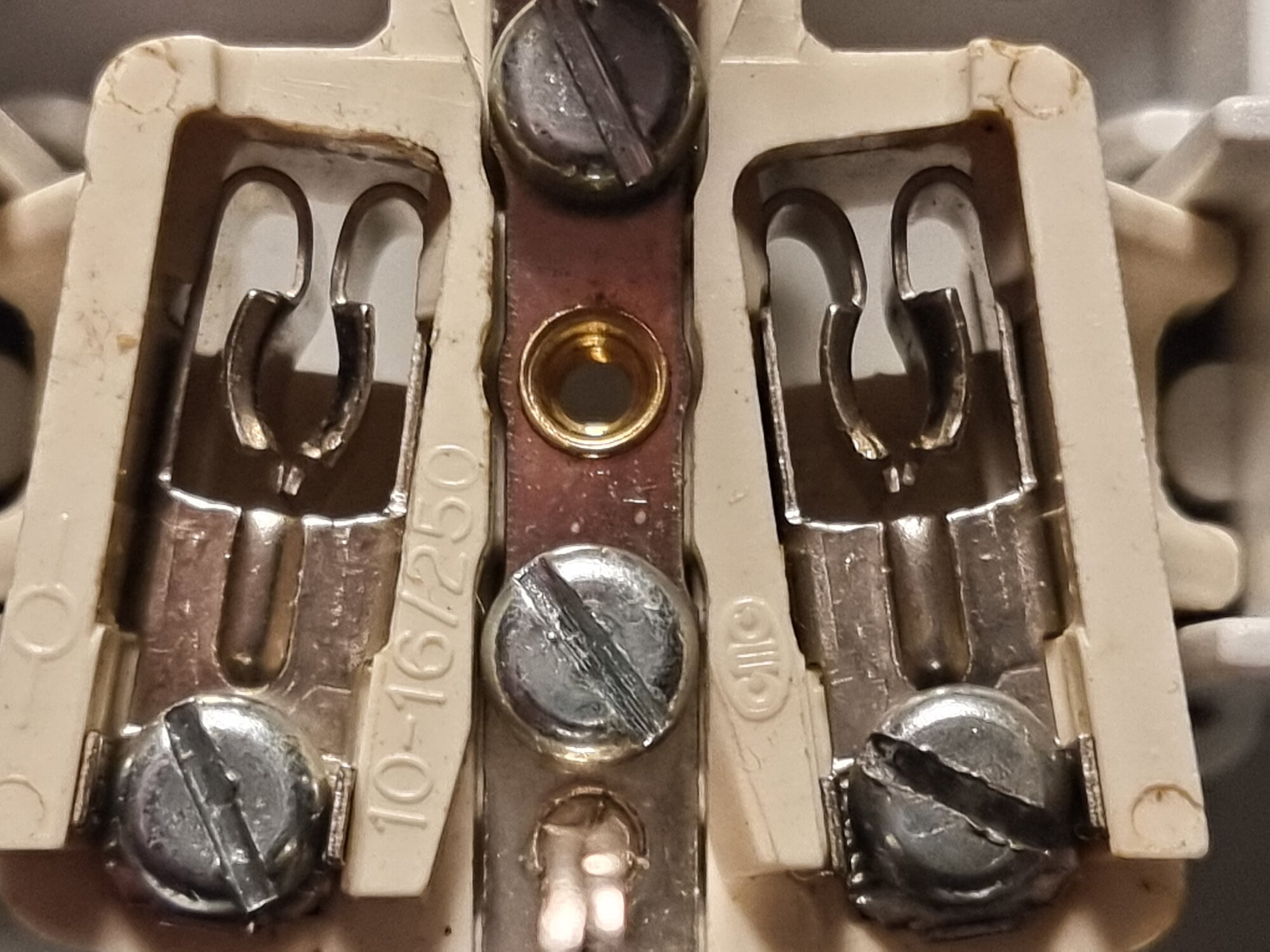

IME yes, good quality Schuko-Steckdosen are fine at 16A continuously. They share with many of the world's plugs the advantage over BS1363 of not having a heating element attached to one of the pins. Cheap imported trailing sockets etc. run the usual gamut of constructional quality from OK to rubbish. Many parameters are of course shared with other 19mm-centre standards such as CEE7/5 and my hobby horse IEC 60906.
One design feature common to most good Schuko socket contacts is the significant length of live spring between anchorage and interface surface, of relatively high spring constant. It is impossible to bend any part beyond its elastic limit even with a grossly oversize pin clumsily inserted. Due to its double-curvature, the interface area remains rigid while the springiness comes from further along the contact where it is thermally decoupled by the large dissipative surface area and less prone to losing spring temper through heating.
Pics below show a good quality wall socket and trailing socket from the late 1980s that clearly illustrate the contact design with and without pin in situ.
