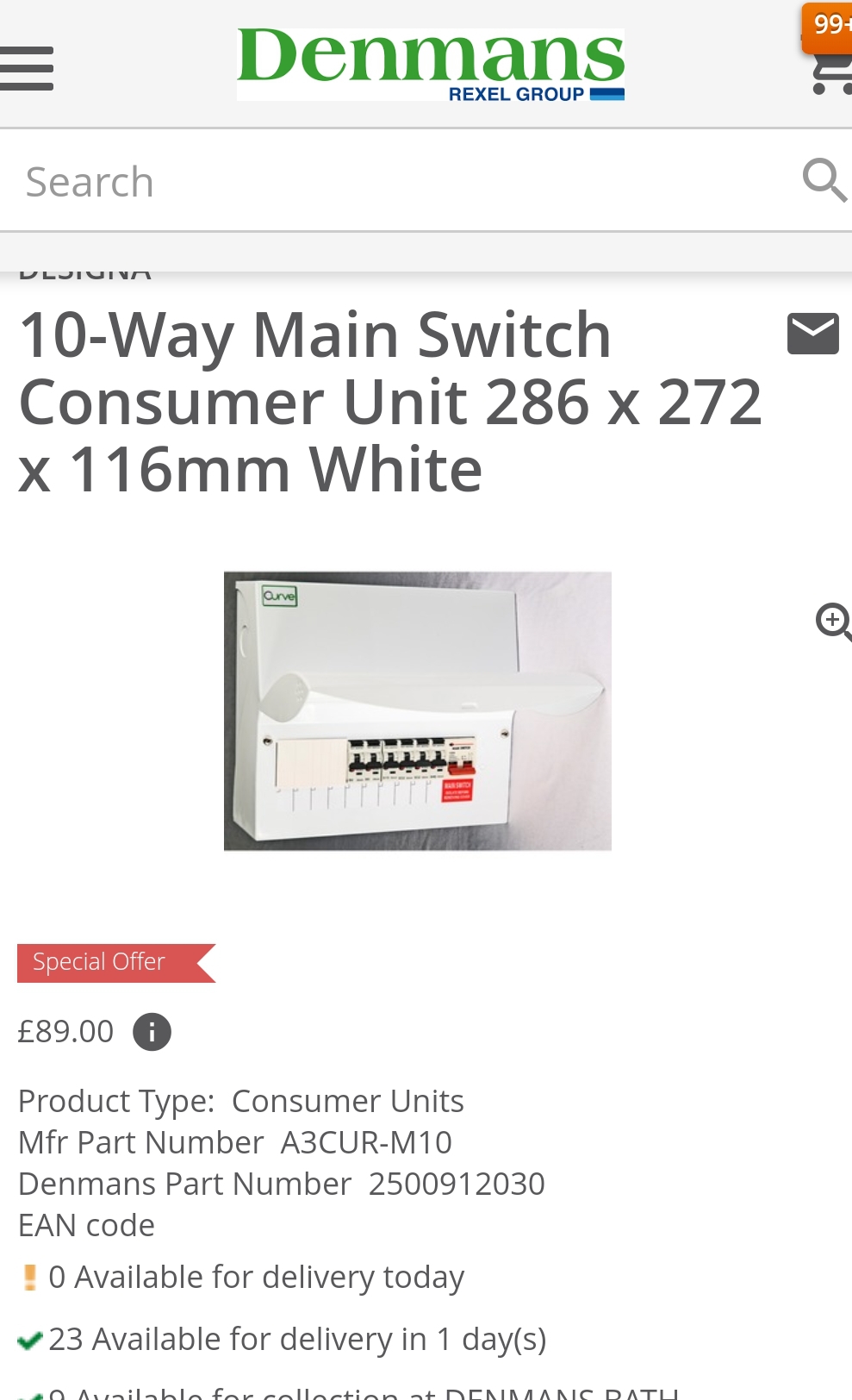

Denmans do a decent rcbo populated board for £89 plus vat and you can get extra rcbos for 11 plus vat each. The cu has decent space uptop too for dressing it well. Comes with 6 rcbos
With denmans you can normally ask for discount if buying a big order. So ask the manager and good chance youll get 5% off if buying a couple with rcbos too.
In your case youll get next day delivery to NI. Ring them and ask for a discount... they give you £30 off your first order if you open an account anyway
So are Denmans part of the Rexel Senate group?
That price for a 10 way populated is one of the best I've seen for
a while. I could have done with that this week. Went for a dual RCB instead.
