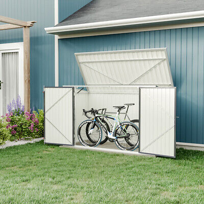

how about something like this to keep the wind and rain off?
if need be, you can always cut extra holes in it if you feel the need for extra ventilation.
That's a great suggestion - thanks. I had looked at cheap PVC green houses and even cheap, end of season tents at Gooutdoors, etc. but hadn't considered the plastic kennel. Cheers.

Very smart looking and would work well. Sadly, I'm trying to keep the cost under ÂŁ100 if possible. Thanks for the suggestion.
