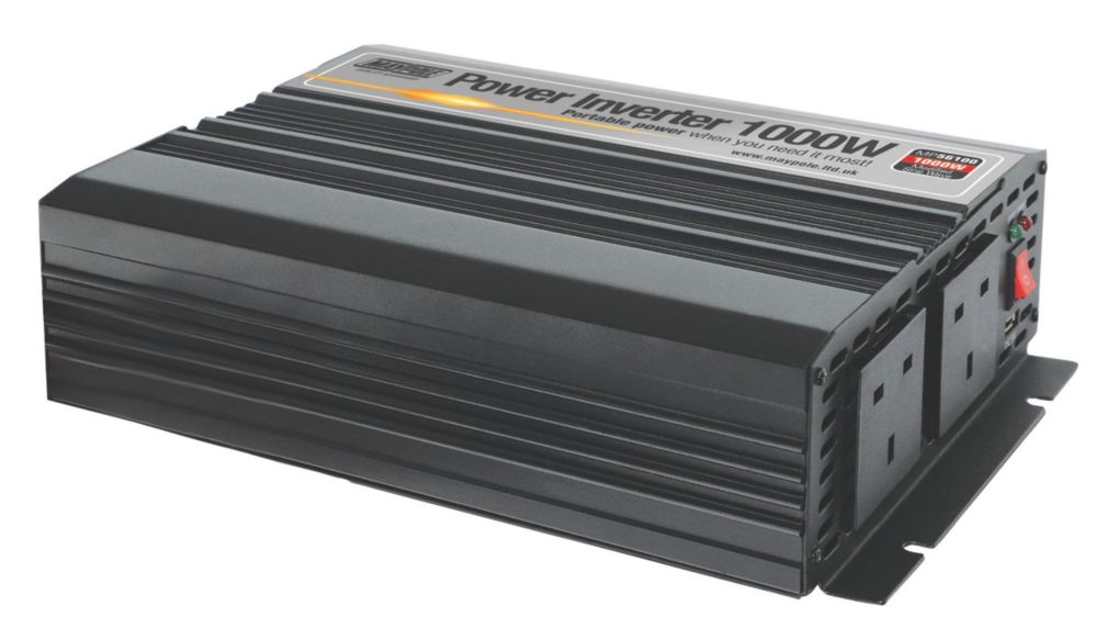

A possible alternative, one that i have used myself for exactly the issues you describe. I too used to have a small petrol generator and have used it occasionally but found it noisy and always running out of juice.
I have a 1000W inverter built into my car, i use it for long sessions on the laptop and charging batteries when i am out in the field. When power is interrupted at home i have run an extension from the back of the car to the house like you describe. The items you describe take very little power but anything adventurous like the fridge/freezer are doomed.

https://www.NoLinkingToThis/p/maypole-mp56100-2-1a-1000w-power-inverter-with-usb-12v/113fy
If you want a deluxe version which has a better waveform
The cheaper version is OK for phone chargers, router PSUs etc but if you are unsure and have anything with a magnetic component like transformer, motor or a very expensive TV , lol i would go deluxe.
Also if you do run all your electronic equipment overnight, you may find a flat battery in the morning... eek
