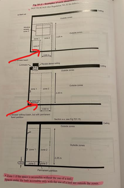

The zones are for distances from baths and showers.
As you see, depending on the distance, there is no zone for a washbasin. Also it is within a cupboard.

I thought the enclosed clause was if it was only accessible using a tool.
Firstly, I want to shake you by the hand as you have unwittingly solved a long standing mystery for me.
Until this evening, I have never managed to see what that * at the bottom of the page was referenced by. I knew the rule from the text earlier, but couldn't ever find any corresponding *'s.
I had clean glasses for once, and was sitting in the best lit chair in the house, and bingo! The two tiny specks leapt out for the first time ever. And by heck they are small! One less mystery in the world.
Ok, now that's out of the way. The tool thing is only relevant if the area in question is in zone 0, promoting it to zone 1.

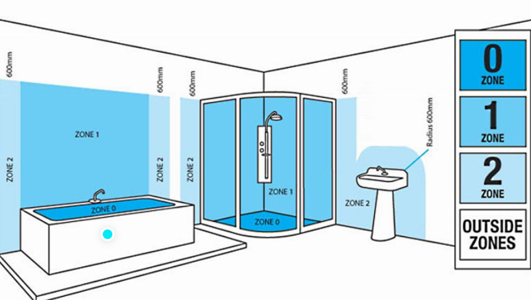

There are no zones specifically relating to a wash basin (don't be confused by the hundreds of diagrams on the web showing a zone around a basin, they are all wrong!).
e.g. THIS IS WRONG:
So forget that bit completely.
Normally sockets are permitted 3m from zone 1, but the cupboard counts as a fixed partition (see 701.32.1 General) so is out of zones even if the room is small that the wash basin is within 3m of zone 1.
