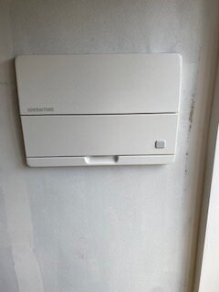

The Contactum Defender 2 range is quite aesthetically pleasing in the surface and flush mount models although not sure of the dimensions of a 12way unit.IMG_8270.jpg

The door cover is perfectly flat, and again I think it can be painted to match wall decoration.
