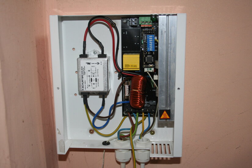

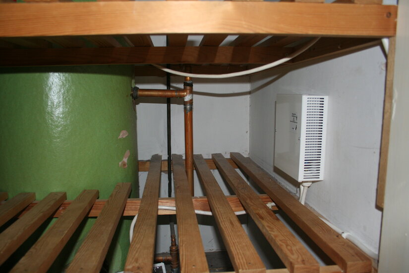

The power throttle is a white box with no identifiers on the outside. I have attached a photograph of the one controlling the immersion heater so you can see the positioning, and a photograph of the inside of the other as it's easier to get at. They are identical.
I hope that helps. I also hope you can open the photos in full size - not sure I've attached them correctly.

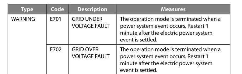

Thanks very much for your interest. It was Hansol who told me that it is overvoltage. The A10 has an LCD screen which shows an error message - E903. The User's Manual describes that as "Single fault event. Occurs on system connection standard single fault over. Contact the installer immediately."

The mains voltage monitoring you've had done appears within range. If it had been out of range, I'd expect to see E702 displayed and then restart after 1 minute, which is not what you've seen. So I don't think much of the advice you've had that there is supply overvoltage, two strikes I think.

The fault code is a 'significant' one which arises from a 'protection' fault which does not clear in time.
