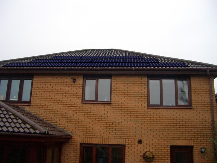

You wont do too many jobs like that and as you get used to the programme it takes less time. I have a bigger issue with fact that I cant even offset panels
So to achieve the layout in the image I had to put the first row in then save and then add the second row and save and then the 3rd row.
Are you talking about PV Sol Expert or Photoplan? The image above is from Photoplan.
You can throw panels wherever you like on Expert - landscape, portrait, different roofs, different orientations. The limitation of the software comes when you then try and connect these panels to an inverter.
Are you saying that I can take an image and put panels on to give the same type of image as photoplan?
Does it look different from photoplan?
Not exactly an image, but a 3D drawing that you have created yourself - no problem.
Yes I have expert and use it for creating 3d drawings. Find it very useful when doing shading calculations.
I like photoplan for presentation purposes. The customers like to see a picture of their house with the panels laid out on it. I thought that was what the original poster was trying to achieve.
