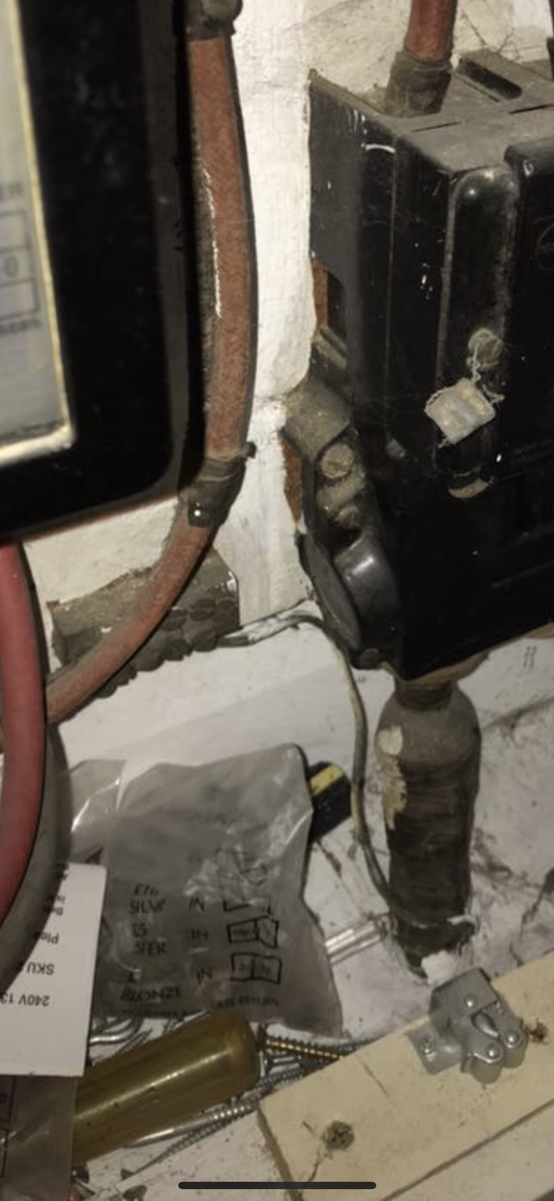

I’ve a question I hope you can help with. I’m upgrading some of the electrics at my brothers place, getting rid of old rewireable fuseboard and putting in a new consumer unit, new ring final for his ground floor. However, when I went to check the bonding to the utilities, there wasn’t any at all. I’ve checked both supply pipes where they come into the building and at the stop cocks. I thought maybe I just couldn’t find them, but there’s nothing in the MET apart from cpc’s from the 5 circuits and a 6mm earthing conductor to an earth block next to the supply cable. So obviously I’m installing bonding now as well, and here’s my question.
It’s a TN-S system, with a couple - literally two strands of armour that seemed to have been unravelled from the supply cable when it was installed and connected to the same earth block. I can post a photo in a few hours if needed.
My gut is screaming out that there’s no way those two strands are capable of carrying any decent PFC?
Everything I’ve read says it’s the DNO responsibility to sort this, but I’ve also read that if you call them they’ll just say stick a Tenby clip on it - which I don’t think is right either as it's likely to come loose.
So am I being paranoid about the armour earthing and where do I stand when speaking to the DNO?
Thanks in advance! Mike

Photo added for a bit of clarity
Is that the 6mm coming from the U/G cable? going to the MET?
Hope I haven’t caused more confusion, my brother sent me the picture before I started, so I had it on my phone and I’ve just cropped it.
The connection you can see between the supply cable and the earth block looks like it’s just a couple of strands of the armour.
The 6mm connection to the board is helpfully just out of shot and behind that meter tails and runs behind the wooden board the meter is mounted on, so it’s just out of view in that picture.
Have you taken any Ze readings? best all round to get the DNO involved, if the Ze is not up to scratch.
that looks like it's PILC supply cable. the earth connection is sweated onto the lead sheath. as was done donkeys years ago. get a Ze and PEFC readings. you'll find that it's probably adequate. then sort out your bonding.

@ 0.21 ohms, that gives a pefc of appeox 1kA. adiabatic tells me that 2.5mm is adequate for a MEC. so that tail off the lead sheath will comply.
seen quite a few like that, been in for years. never seen one melted .

That’s not a few strands of the armour, it’s a tinned copper braid.
I've had several jobs with TN-S systems provided originally by NEEB now Northern power grid. When their earth has deteriorated well over 0.8 ohms.(lead sheath)and has been reported, they've said you'll have to pay for a connection or provide your own mean of earthing.
