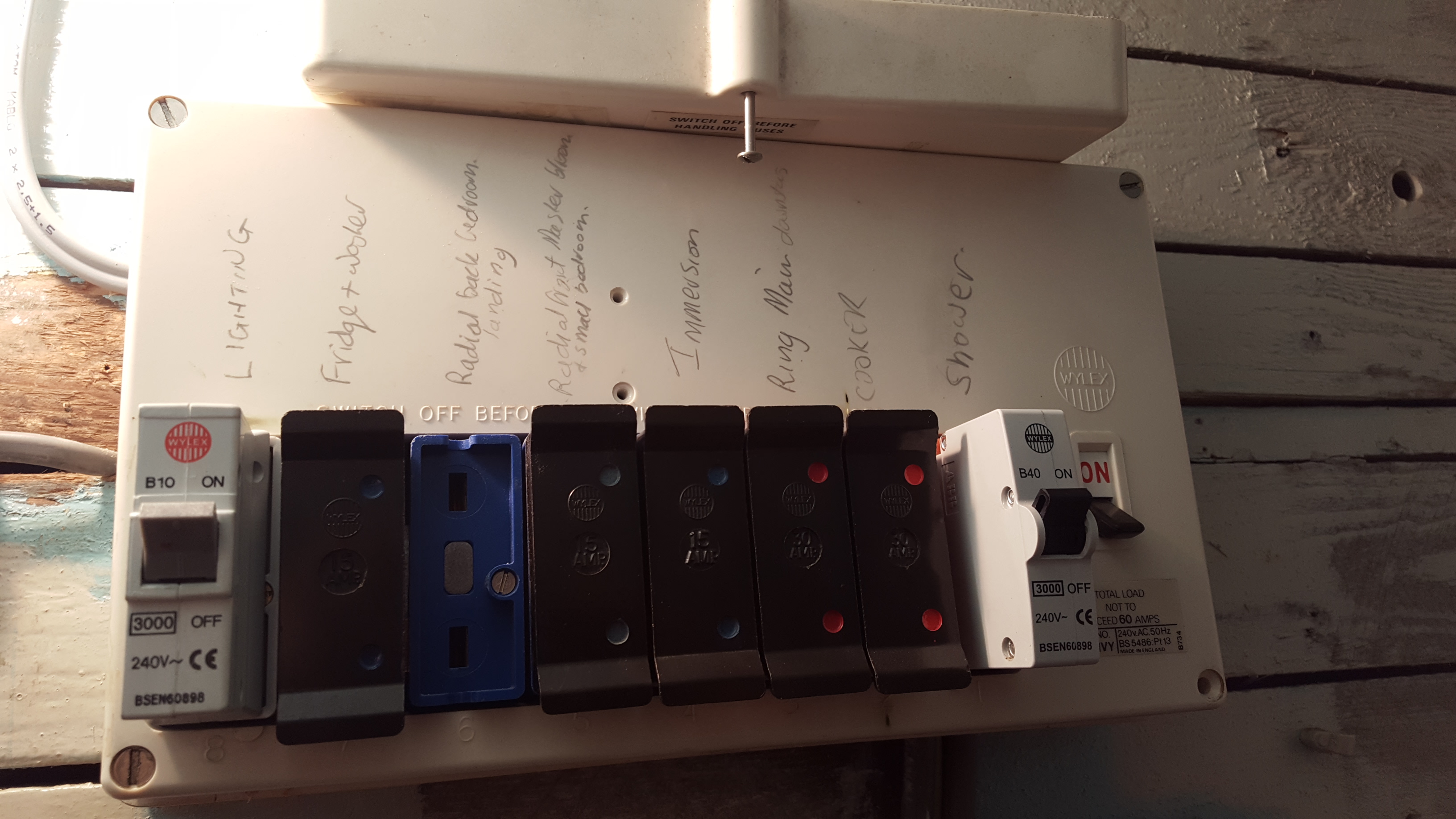

Mate you seem to be getting MCBs RCDs and fuses mixed up, which in turn makes your post difficult to understand, is there any chance you could post a picture of your Consumers Unit (fuse box), it would go a long way to helping people decypher what exactly you have as far as electrical distribution in your house, please get back as soon as you can.
Sure please see below.
TLDR: Sockets in one room and landing seem to operate with either lighting or the specific fuse for the radial upstairs circuit on at the control board. (And the control board doesnt have RCD protected fuses)

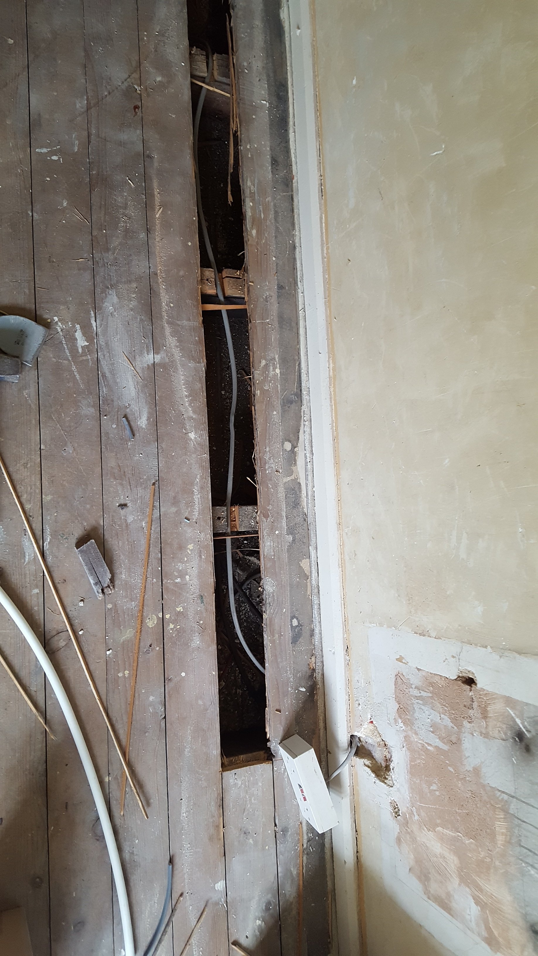

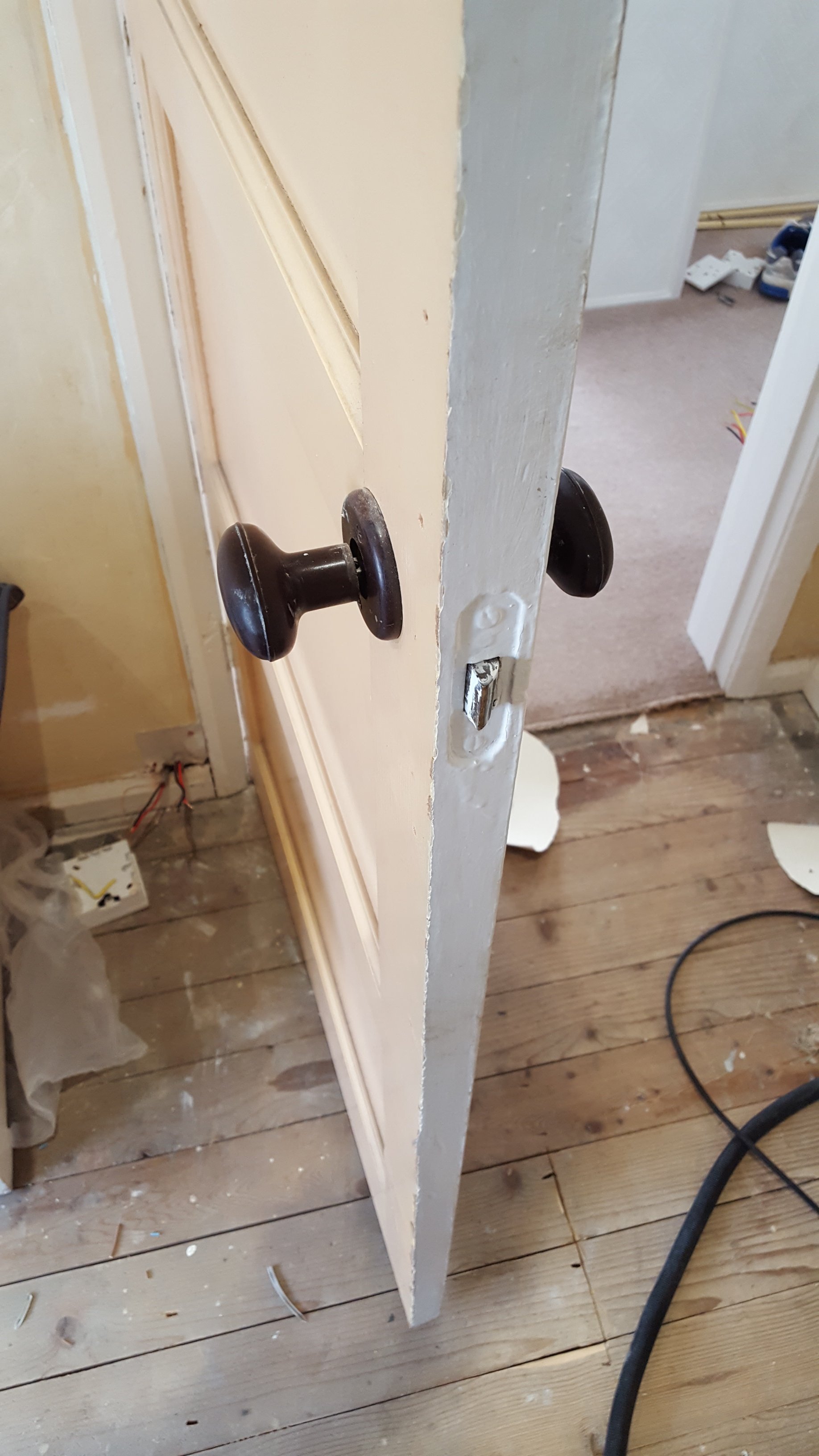

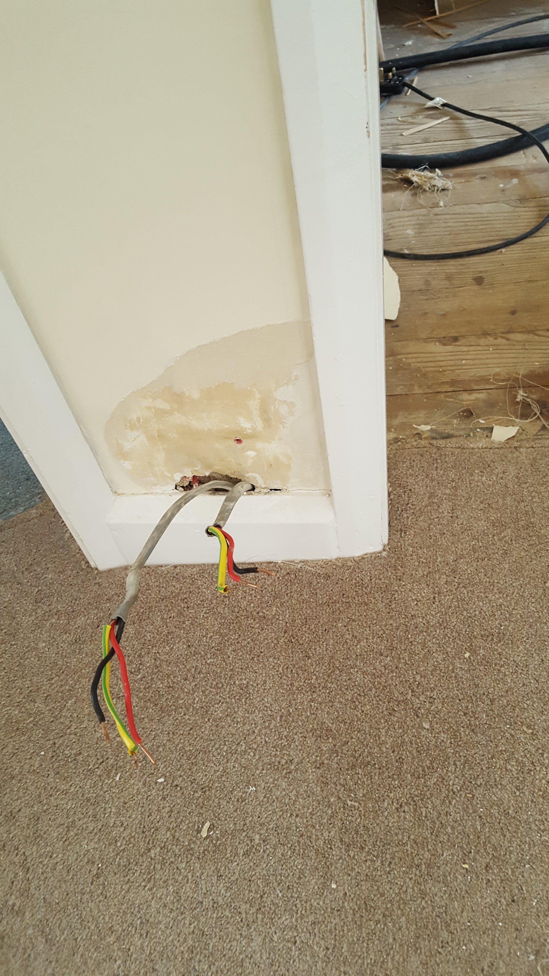

Here are the three sockets which appear to be live when either the lighting MCB OR the radial fuse are on/live.
It seems the last socket is the one in the 2nd image (134933) as that only has one wire going to it.

You need to employ an Electrician mate to sort this out, obviously somewhere inside your CU someone hs botched up the circuitry.
The electrician is already booked and coming to change the consumer unit next Thursday and obviously has to test the whole system afterwards, I have given him a heads up about this new finding but was curious as to what people thought the likely cause was sounds like mis-wired consumer unit most likely then?

if EITHER the lighting fuse OR the radial fuse is on, these three sockets receive power.
The is a connection between the live conductors of the two circuits. This could be in the cu, in an accessory or other termination, or due to failed insulation somewhere.
Only a fault finding procedure including testing and inspection of the circuits would determine where the issue is.
