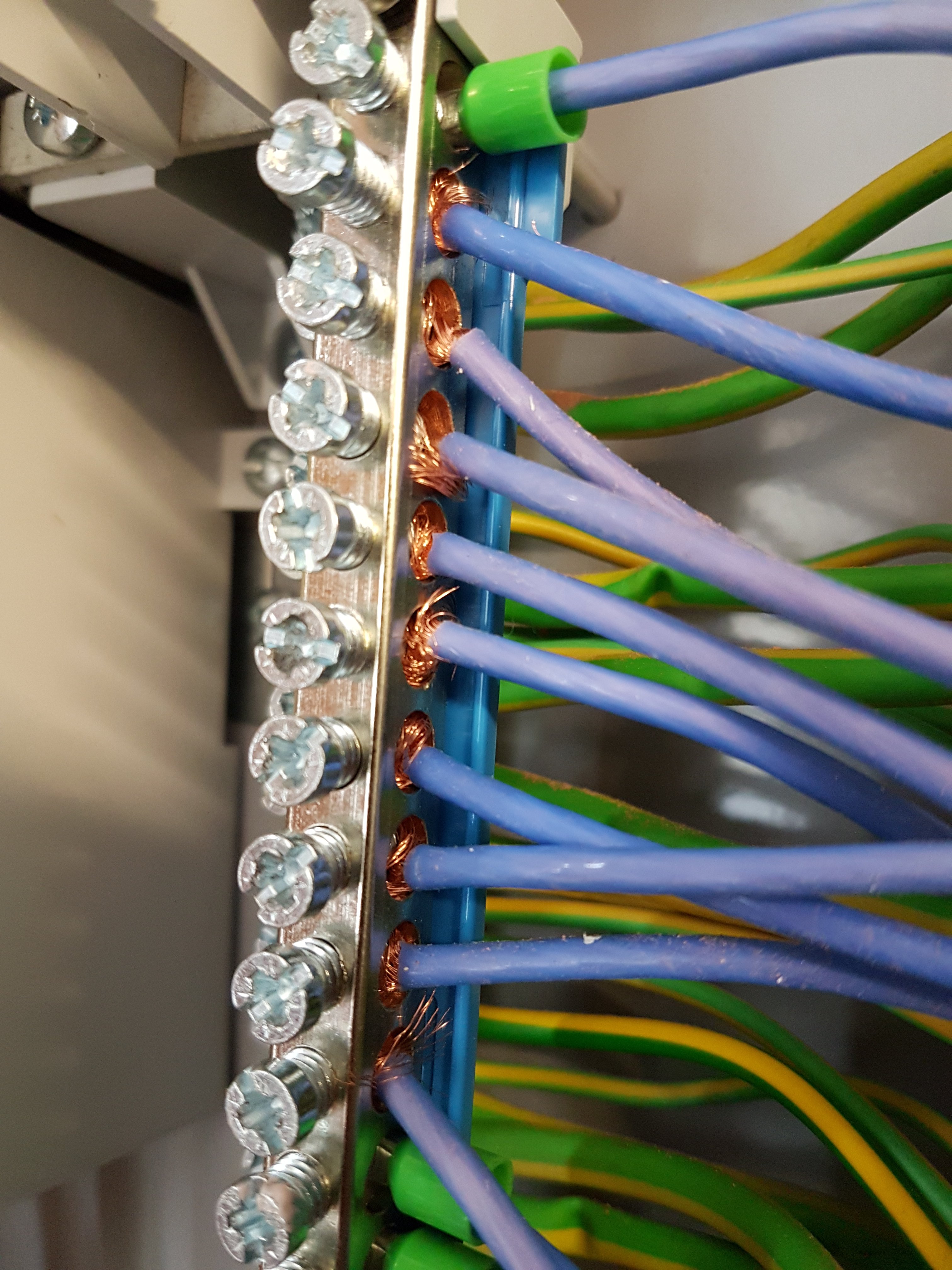

Has anyone got any tips and suggestions for terminating RCBO's neatly in consumer units?
I'm more than happy with how I present my dual RCD and MCB CU's but I find that the flying neutral and earth from RCBO'S don't hold their Shape like a solid core cable would and often sag and look unsightly.

You could try some sleeving as long as it's the correct colour.
Are you sure you aren't going too far? At the end of the day the customer isn't going to be too happy paying an extra hours labour just so the neutral tails are all lined up :)

You can either tuck them behind the din rail then loop up to the bar, or cut and crimp the leads so you can dress them with whatever length you want.

Here was a nice tip from a previous member ‘pennywise’ - may use this idea in the future as may help no end, you don’t know until you try.
Quote -“I use the cable tie sticky pads, then make a loop with a tie and just don't tighten it up, then it just guides the cables rather than making them into one solid mass that could heat up.”

This is a couple of before and after pics. The Memshield 3 neutral leads have all been cut, the leads have hair like strands and as you can see without ferruling they look pretty poor.
Better, but green ferrules are for 6mm. Not only do they look better when properly ferruled, but it's against the regs not to!
Or 16mm if you like the German ones...
Either way those pictured are way too big and will not crimp correctly, even when you graunch them up with the screw...
